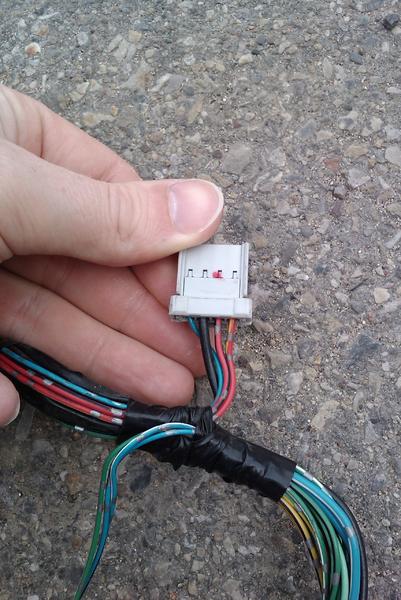

So I think I might have this figured out. I got all the parts from the donor car which is a 2001 so while I have all the wiring harnesses and switches, the plugs on the ends of the harnesses are a bit different and don't directly plug into the fuse panel. However I think I might have this pretty much figured out. The motor needs to be hooked to the switch and the switch needs to get power/ground from a 12 volt source. As far as I know, that's pretty much it.
The first picture is the plug that goes into the switch.
The second picture is the plug that goes into the motor.
As you can see, there are 4 wires going into the motor - blue, black, red/black, red yellow. The same 4 wires go into the switch, the reason there are so many wires is because this is the driver side switch which runs both windows, the passenger side only has 2 wires. So I've got to just isolate these 4 wires and plug one end into the switch, the other end into the motor. Then all I need to do (I assume) is isolate the only other 2 wires going into the switch which carry power/ground. Does this sound right?
The other things I'm wondering is the switch which disables window use. When the windows are locked, nobody can use them and this switch controls that. And lastly, some wire has to run from the driver side switch to the passenger side motor because it controls both windows.
Are my assumptions right? Any thoughts on my questions?

Hey, I just found a wiring diagram online for the harness. For the driver side power windows, here are the wires coming out of the plug I show in the picture:
Red/Black - motor up
Red/Yellow - motor down
ORN (Orange?) - ???????
Green/White - ignition
Black - ground
Blue/Red - passenger switch up
Blue/White - passenger switch down
Green/Black - ignition and passenger side switch
Black - ground
There is another blue wire coming out of the harness, it's not mentioned in the schematic. Where does this go?
What does ORN go to? Is it short for orange? I don't have an orange wire in my harness.
Does that look like all I need?
Since I have the rest of the harness, I just plug it into the motor and that takes care of the red/black and the red/yellow wires, they're easy. The orange I have no clue because I don't know what that is in the diagram and I don't have an orange wire in my harness. The green/white is easy, I can splice into an ignition source for that. And black is easy, any ground will do. It looks like the ignition wires actually go to the power window relay in the fuse panel though, might want to use that instead of another ignition source.

Well now everything is finally done after over a year of working on it here and there.
If you want to do this, here's what you're going to need:
- both door panels so you don't have a hole where the crank used to be
- both switches so you can control the windows obviously
- both motor assemblies
- the plug which plugs into the switch assembly on both sides
- the plug which plugs into the motor assembly on both sides
I ended up taking the entire wiring harness for the power windows from a donor car and cutting out all the crap I didn't need. If you do this, you'll see that the harness on both sides will have a plug going to your switch (needed), a plug going to the motor (needed) and a plug going to your vehicle wiring harness (not necessary). Because I pulled mine from a 2001 and put it into a 2005, the plug for the factory harness didn't fit so I had to wire up manually, not a big deal. If you get one from the same year it should plug right in.
Because I had to wire up manually, and I didn't know which wire converted to which on the other side of the harness, I tied in to the wires directly, here is a schema for the wire mapping from the power window harness:
driver side blue/red -> passenger side blue/red
driver side blue/white -> passenger side blue/white
driver side black -> ground
driver side green/white -> switched
driver side green/black -> passenger side green/black -> battery
Once you get all the wiring hooked up and plug in the harnesses where they go, put the door panels back on and you're done.
