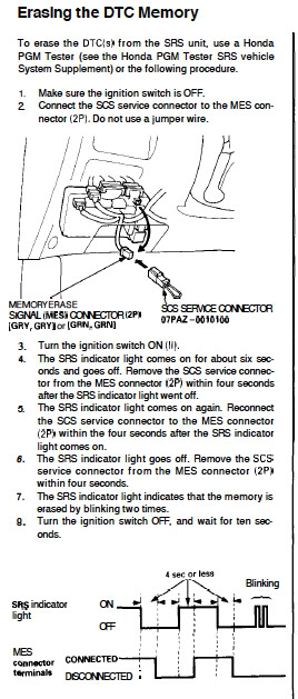

Re: Air Bag Troubles
search for SRS reset. on the 7th gen, you pull a connector under the steering wheel and jumper out 2 terminals in various sequences while the SRS light flashes.
Tip: Use a jumper wire instead of the SCS service connector shown in the diagram.
