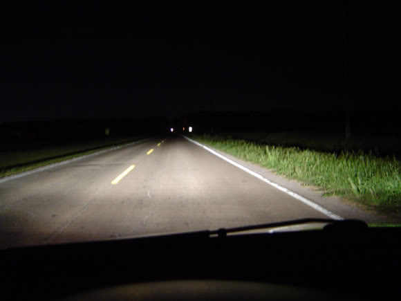

they all suck to be honest. keep the stockers and get some philips XP bulbs. www.powerbulbs.com
oem bulb
xp bulb
