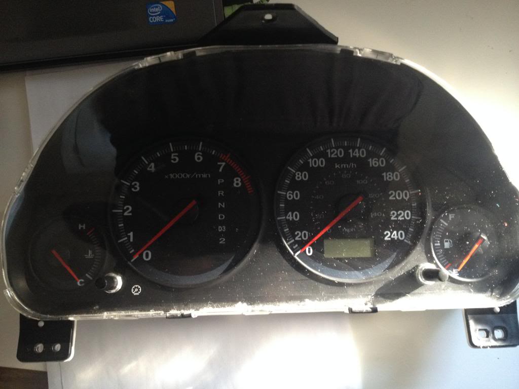

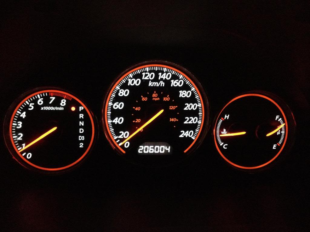

Re: 2003 Civic DX instrument cluster questions
i replaced auto 2001 civic ex to 2003 Acura EL (live in Canada). i paid $25.
it would be so complicated if i did not grab Acura`s harnesses with cluster. However, it took over 3 hours to do cable job. my fingers still hurts. first thing i did was match the cables between new and old harnesses. Canada civic has more cables. i put 4 cables form blue connector to green one. 1 cable form green to blue connector. Also, there was two pink
