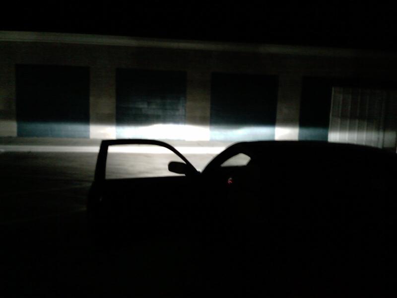

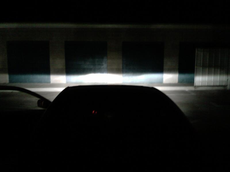

Okay, I went to aim them tonight. I've read how-to from HIDplanet and I think I have the height adjusted and rotation adjusted okay. It still looks a little off to me but I'm not sure how important it is to have it perfect. It's pretty hard to adjust it just a fraction.
My last question is: in terms of how far away the "slants" are, how far away should they be? I can see each independent projector and it's beam in mine. Should they be pointed closer together so they blend?
I'm sorry about the crappy pictures, I forgot to bring my camera and so I just did it with my phone.
and Gearbox it looks to me to be like __/--__/--
I'm not looking at it wrong right? haha

i think its fine. purpose of aiming is to provided usable light at a fair distance and no blind people. long as it does that, i don't think it has to be absolutley perfect.

ha yeah my bad. in the last pics the steps are correct. the aiming looks right on the money. as far as space between them, they should point straight out from the headlight without pointing inwards or outwards. again, doesnt have to be exact. mine are a bit inwards so they start to blend a bit at longer distance.

very nice. i'd bring in the passenger side a bit to the left. even at 25 feet, the high side of my driver side blends into the high side of my passenger side. ideally, when the beams merge with the road at a distance, the beams should appear as one. fine tuning can be a real PITA. the only way i could tweak mine was to drill holes in the back of the housing so that i could make adjustments while the lights were on the car.
