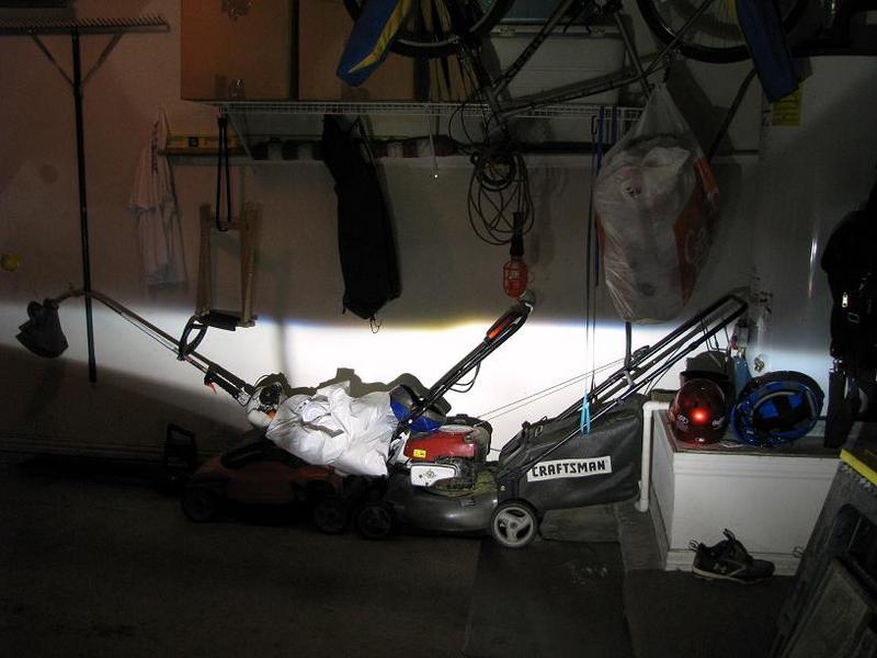

Okay, I ended up getting the same headlight housings as Gearbox said that he bought.
I fired up my headlights for the first time today to see if they worked. Everything powered on so I'm pretty excited to start on this project.
Hopefully I can get it done during my Thanksgiving break. I'm a little worried though because I can already see 1,000 roadblocks that I will have to figure out. I'm not too good at this most likely, as this is my first major modification to my car.
I attached some output picks if you want to see.
I have E46 BiXenon projectors, with stock ballast and bulbs as far as I'm aware.

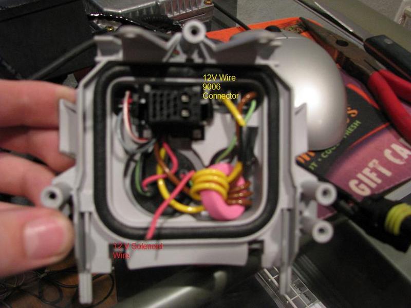

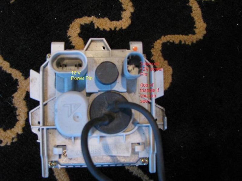

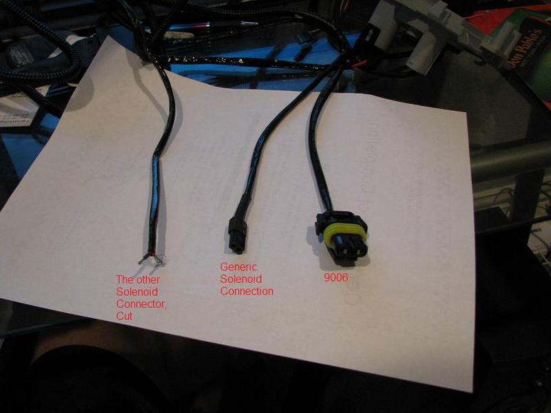

Okay I'm in the process of trying to get the Highbeams to work on my projectors. I ran across this website http://integramod.tripod.com/product..._ballasts.html , that said I could wire up my solenoid using the circuit board on my OEM ballast. I opted for this because I am lost at wiring (electrical stuff in general, I'm learning slowly) and could not understand HIDPlanet e46 solenoid diagram.
Well I'll try to explain this my best, but here is my problem. On the guys website he says, "So all you have to do is cut the red wire going from the ballast to the solenoid, and connect it (on the solenoid side) to your switched +12V source".
So I took switched +12V source to mean the yellow wire (9006 power 12V). But I should have realized before that if I do this whenever I turn my headlights on, my high beams will be on. Lol, well that's exactly what happened so that can't be it.
So then I thought, well I bought a premade wiring harness, for H4 to BiXenon and they had connectors for solenoid, they were just the wrong ones. So I cut the connector to that part and hooked up the positive wire to the 12V solenoid wire inside of ballast. Powered everything up, and still nothing.
So then I tried testing the wiring harness solenoid wire with multimeter. I connected the postive and negative to it, and nothing. Zero V at all. So I have no power running through my solenoid wire right (on wiring harness)?
I tried to get a reading with the headlights: on, off, and highbeams on. Still nothing. Am I doing something wrong? Should I just scrap high beams all together? I got the lows powered and working.
I attached some pictures. Sorry if this is long, thanks a lot.

are you sure you were reading the connections right? you know our cars are negative switched, right?
Old Nov 13, 2008
gezer77's Avatar
Joined: Mar 2008
Posts: 21
From: Fort Worth, Texas
gezer77 is an unknown quantity at this point
Re: Projector Headlight Housing or OEM?
could you be more specific, which connections do you mean? I did know that we have a negative switched (ground switched same thing right?)
Problem is I don't completely understand what this means in terms of my problem.
I have the 12V power from my harness. And isn't it grounded already with the stock wiring between ballast/solenoid.
Or am I way off somewhere?

you have +12 that comes on with the parking lights and stays on. the low ground only comes on when you turn the switch to headlights on. the high ground comes on with the high beam switch and the low ground drops out at the same time.

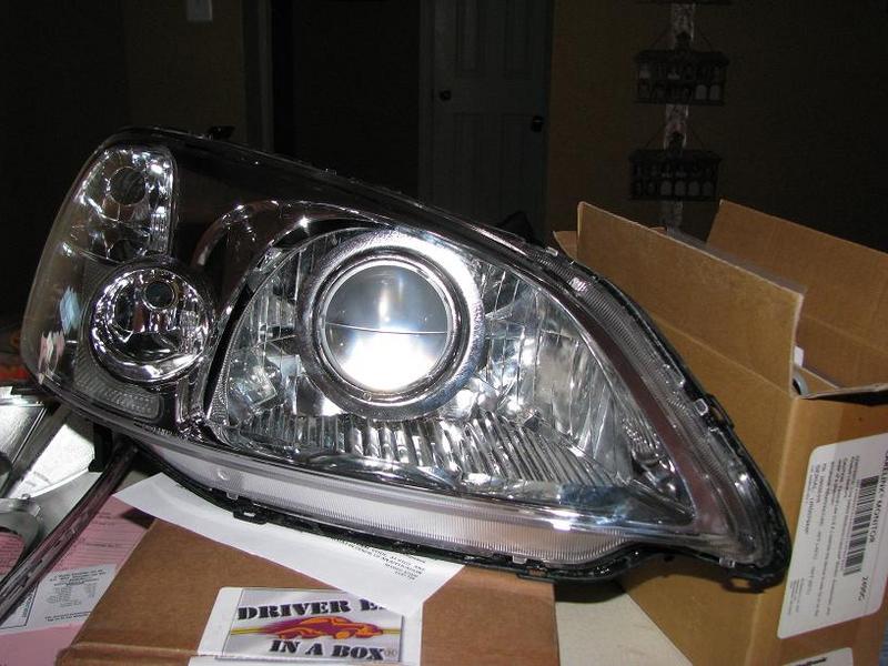

I put the lights on tonight, and just did some rough adjustments. I drove around the neighborhood and wow it is amazingly bright lol.
All I have left is to aim them, and to put everything back together. I'm pretty excited, surprised my first retrofit went as smooth as it has.
That's my output picture, and also what I hope it will look like when it's put back together.

I figured out I can reuse the rubber grommet from my stock headlights, so I'll do that.
My only questions now are do I just reheat the headlights in the oven or should I do something more to seal it.
And do my e46 ballast's need to be waterproofed. I'm going to check out HIDplanet and see if I can find that. I have been unsuccessful so far.
long as you didn't take off too much of the oem sealant when you took off your covers then it should be fine.
the e46 ballasts dont need to be water proofed, there already water resistant unless you plan on submerging the front end of your car in water.
