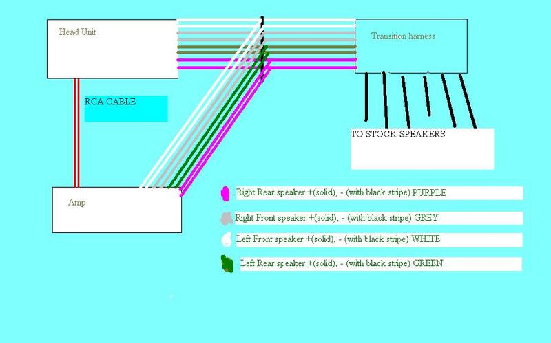

It a little confusing but insted of running the wires from the transition harness to the head unit run them to the amp and tape off the ones comming from the head unit and make sure there not touching will require you to run new wires from the harness to the amp where ever it may be located SORRY BOUT THE GAY PIC CAMERAS BROKEN

amp is going in the rear of my pilot.....it is an lx so i dont think that there is a factory amp....if there is it must be small
ok so basically all i need to do is T-tap or splice the speaker wires from the harness with the signal from the amp?
I know all about running the rca cable, i was just wondering about how to splice the amp into the speaker cable without having to run new cable to the speakers....

Yea but the wires on the back of the head unit dont go to anything they dead end and it doesnt matter with stock speakers about the wire gauge

the music signal will come from the RCAs eliminating the need for the head unit wires
