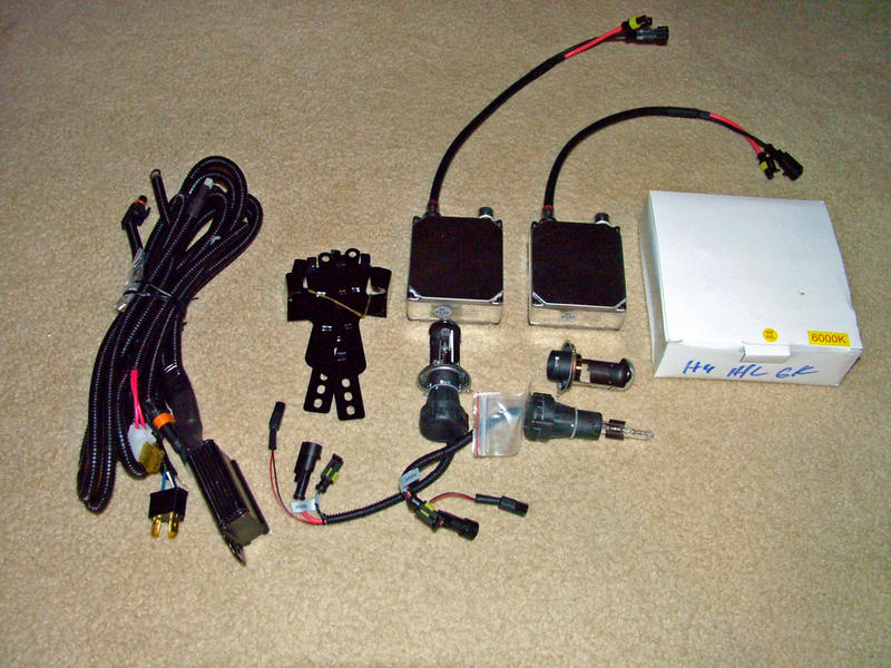

It arrived today. It looks like the ballasts are housed in Stainless Steel. The kit looks of pretty good quality! The bulb has a shield at the back of it where it moves up and down and it his a opening/slot in the outer part of the housing. I don't know how well it will work but I guess we will see!
Hopefully the pic comes through:

did that harness come with it? or did you buy that seperate? it's kind of hard to tell, but it looks like that harness has a relay on it. what is the black box on the bottom right of the harness in the pic? is the yellow item a fuse? does it instruct you to connect the harness to the battery or just the H4 connector. i see only one H4 connector which leads me to believe it's a relay harness. if that's the case, then that's great.

Relay harness. I had to ask for it in the additional comments but it did come with it! They sell them seperate for $35.00. I paid $199.00 for the entire kit shipped and it arrived in 2 days. The maker is ExSun and they have a site.
Think it will be a pretty nice piece?

good deal man. good price for an H4 harness too for bi-xenon. the H4 harness suvlights sells is $65 and it is low beam only. post some output pics when you get them installed. i'm curious what the beam patterns are. get some road shots as well as some shots on a wall at 25-30 feet away. if these turn out good, i may snag a set for myself.

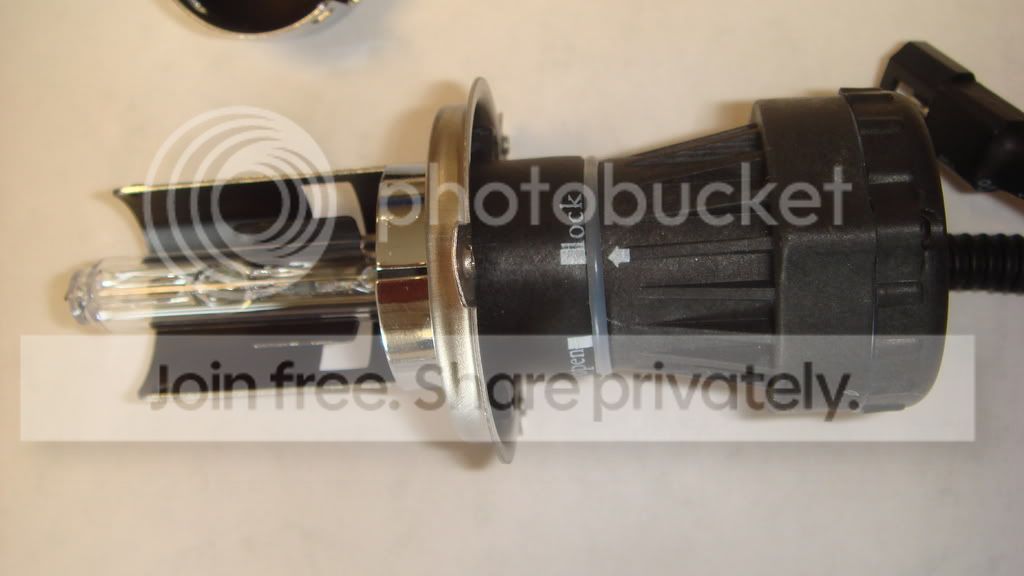

The place I got my HID's off of said I need to remove the end as pictured:
Will that help me any? Then I guess it will be relying on the inside shield that is part of the factory housing. Will that change things? This guy seems to think it will. Any thoughts?

yeah, remove that part, not the shield inside the headlight housing. what that does is more closely mimick the low beam filament of the H4 bulb. if you look at one, you'll see what i mean. there's a small shield under the low filament. don't modify the headlight housing shield.
