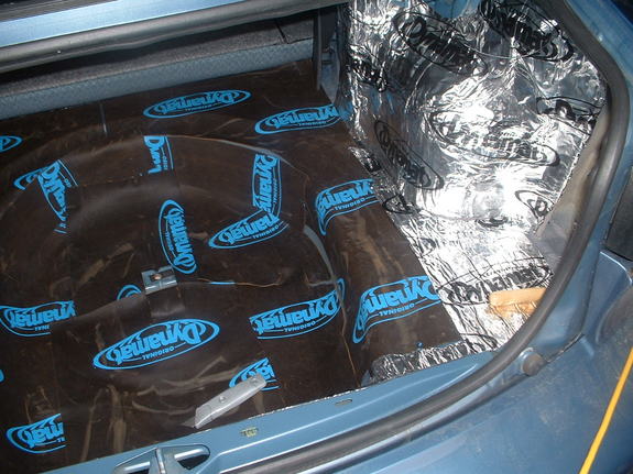

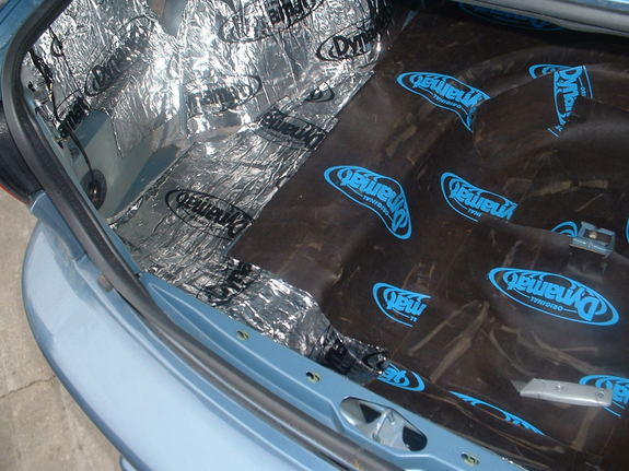

heres my em2 with raammat on the entire trunk:
