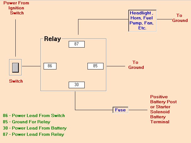

does any one have a switch diagram pic? I wiring my fogs cuz the eday harness doest work.

Just use a relay and here is a diagram to help.

thanks but I just need the diagram of the fog light switch its self. cuz I need to know what each of the little metal connectors do
