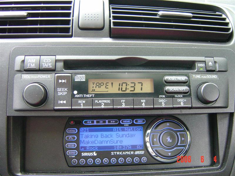

i did mine a little differently
i made it where the audio comes though the headunit via the tape button. took a little work to make it do that, but in the end the audio quality is 100 times better than the fm modulator option.

wow that is super clean. how did you ever cut that piece out so perfectly.
i wish i was the one that made that peice, but i didn't. there is a sirius store that sells that part, except it is too big to fit in the stock hole, so i trimmed it a little to squeeze in

Ya FM modulators don't have the sound quality of a direct connection. You're modulating the signal than demodulating it in the stereo, any type of mod/demod setup is going to have loss in SQ... Direct connection will be better.
thats exactly why i have mine going from the audio output from the sirius starmate directly into the radio(tape input feed)
