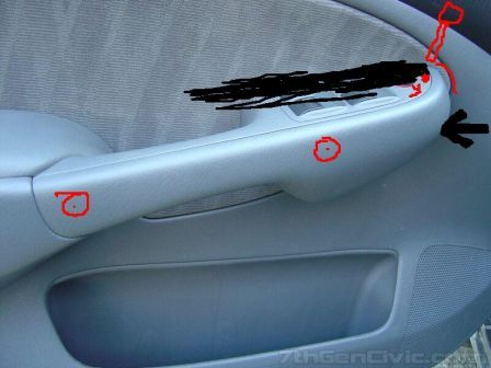

Second, Looking at your picture of the armrest, look at the side closest to the speaker, you will see a little notch in the plastic and a little tab inside the notch. Get a flat screwdriver and put in between the notch and the tab, not against the notch and door, and push the tab in alittle and and turn the screw driver. It will pop the front of the plastic off and the back just has two little plastic hooks. After that you will see two phillips screws that hold the door panel to the door. There should be one towards the front and one towards the back, behind the piece you just took off. Then take out the little piece that we almost all have tweeters in. The little piece above the door. Pop the top out and lift it a little. The bottom just has two more little hooks that hold it. The you got grab the door panel from the bottom by the speaker and give it a tug. There will be about eight or nine little white plugs that hold it on. Just make sure if you pull any out of the door, you take them out and re-insert them in the door panel. You'll see what I mean when you get this far. Hit me up if you need any thing else.

Ok look at the pic closely I did up...You see where there is a red square thing thats a screwdriver just put it right there and pull towards you ..that piece will pop off then youll have 2 screws inside aprox where i did the two round circless..
and where the door handle is just pop off that small plastic black square piece and 2 screws will be there...
Then once its all of grab a screw driver and put it at the bottom of the door where th panel ends..and pop it off..
be carful the door handle needs to be shifted sideways so that the panel will slip through it

you don't need a panel popper. Just pry the panel up a little bit by the speaker and give it a tug. It will pop right out. And for Vipers pic: Move the screw driver down where my arrow is and you'll see the notch I was talking about.

Yeah I just went out and saw the notch you're talking about. hard to see when it's on the underside.
