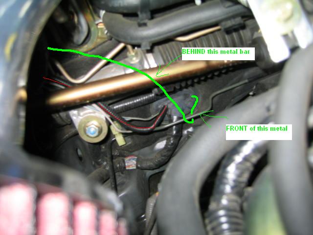

so in the photo i toggled with, the red line area is your power cable right?
the green marks is the way i did mine. it starts from firewall going upward in FRONT of the metal black bar (on my ex, its bigger and thicker).
than i loop it up more til its BEHIND the golden/bronze bar then behind the grey box thing on the upperleft corner on the engine bay.
i ran it like that because i thought that pump looking thing will heat a lot so i tried to avoid that as much as possible.
is what i did fine or should i make some changes?

J187's Avatar
Posts: 4,559
From: MA
Rep Power: 311
J187 is a glorious beacon of lightJ187 is a glorious beacon of lightJ187 is a glorious beacon of lightJ187 is a glorious beacon of lightJ187 is a glorious beacon of lightJ187 is a glorious beacon of lightJ187 is a glorious beacon of light
Perfect. Just make sure you use loom like in that picture - I have no idea who's car that is, the pic comes from this forum.

wire loom is that black plastic ridge covering im guessing? if so, yeah i used that from the firewall to the battery.
thanks for the help folks

Yup, that's what wire loom is. It protects the wire from the heat of the engine. Let us how know how it comes out.

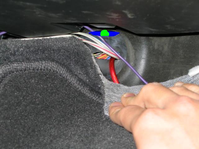

is it ok to let the grommet rubber circular piece hang out a little? i have my power wire OUTSIDE of the grommet making a gap. so when i drive in the rain, would water come thru?
heres a sample pic of what im talking about: the green is the power wire and the blue behind it is the gap space.

J187's Avatar
Posts: 4,559
From: MA
Rep Power: 311
It would be better to run it through the grommet rather than under it. It probably won't pose a problem though. Unless the power wire is rubber up against the bare metal . . .

Jttegx, I would run the wire through the grommet. Under like you have it over time will cause the wire to slowly rub the protective rubber coating off. This could cause some fantastic fireworks one morning though!!!

Originally Posted by J187
. . . . Unless the power wire is rubber up against the bare metal . . .
Exactly what I said.

its not touching any metal, just the outer border of where the grommet is suppose to be plugged in to.

Over time that may rub from vibrations and what not, just a word of caution.
