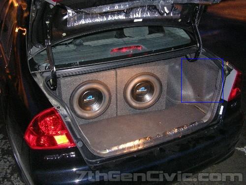

when i hooked my system up, i hooked up the ground behind this area of carpet in the trunk on the right hand side. ( i think the left hand side would do too). if you lift the grey carpet layer, you cant miss seeing the frames of metal/steel. your gonna need to sand off the leftover paint so its bare metal.
sry to whomever original photo that is

yeah use a dremel to sand off some paint, then use a sheet metal screw.. a seatbelt bolt works good, otherwise any place where there's double metal is good for a ground. Yes a bad ground can fry an amp.

I did the same thing. All you gotta do is drill sand some paint off on a small surface, and then drill a hole. Once you drill the hole just screw down the ground wire. I used a washer, cause the connector on the ground wire was bigger than the head on the screw.

^^ This is WAY off topic but your avatar is GREAT.. I'm like.. obsessed with christina (not in a dangerous way).. anyways yeah, If at all possible, use a star washer because after you tighten it down to a certain point, the teeth in the washer help create a more secure ground.
