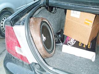

This is gonna be like a strip show here. I managed to click a few pics after work today but couldnt get the juicy stuff. I took these in the parking lot, but it was freezing todayy so it was short. Hopefully work will be slow tomorrow and I can pull the seats and door panel to give you all a better idea of whats going on. First, the enclosure, not sure what to wrap it in though.

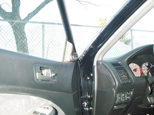

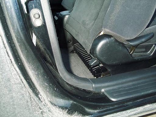

Here's the drivers side amp mounting, tweeter mount, and pass side amp mount, respectively. Not great pics but you can see in the first one the wire ties every inch and a half, etc. You can also vaguely see the plastic spacers that "float" the amps under the seats. Also gives you an idea of how far forward the amps are mounted, they are pretty much even with the back of the seat in the full forward pos on pass side.

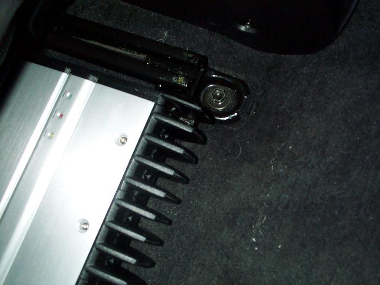

Last pics for now. I tried to get the plastic spacers so you can get idea of the overall height. The only modification to the bottom of the seats was on the pass side. The spring mechanism that automatically slides the seat back was eliminated. In pic2 you can BARELY see the spacer and felt pads under the hardware. Dont worry, the best is yet to come! Also, if anyone else is looking to do this, this will give you a reference for mounting.
