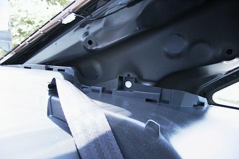

i cant get the rear sides to pop back into place i just changed the back 6x9s the rear deck fit into place fine but i was unable to get the sides in feels like somethings in the way for both of them its just the one clip thats visible that does not go in, its close to the rear deck, what could i do to get it back in ?
or did i mess it up somehow? thanks any help would be appreciated

does your rear speakers even fit? Height wise?

yes there not that high at all clear fine

Keep at it.. it has to be in just right. I had to slide the deck back and forth a couple times before it actually fit in the way it was supposed to

with the sides kinda push them up, in and down and in and they should pop in fairly easy. only thing to be careful of is the little nub sticking out next to the screw hole that has to go inside the hole, if it doesnt go in, it will sit on the metal and get pushed out and make your panel go white.
