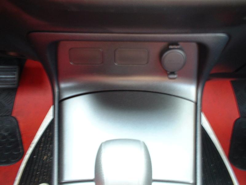

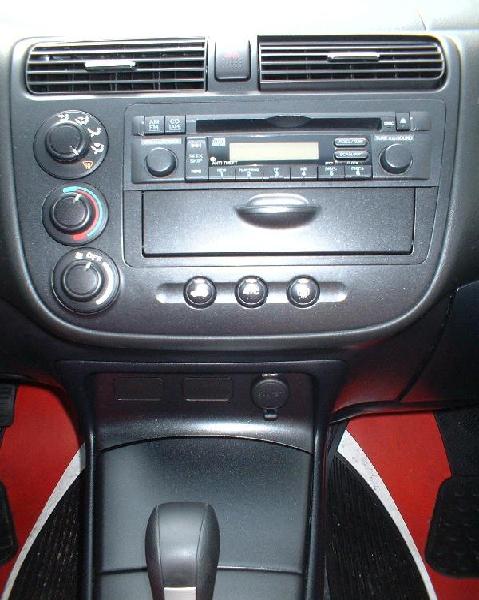

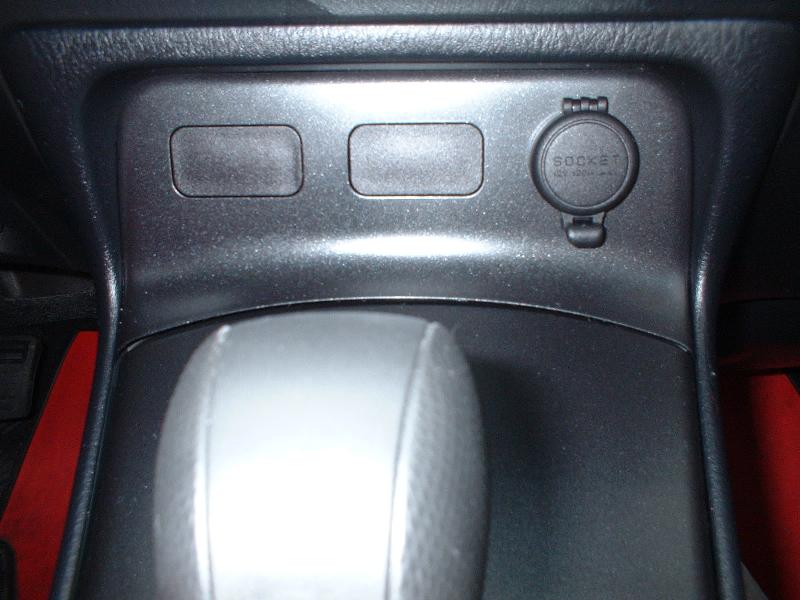

Oh wait, I just checked and my 04 doesn't look like the one in the DIY. It's too dark out right now, I'll try to get a picture of what it looks like tommorow. Has anyone removed the stock HU on a 04?

Here's what it looks like..

I have done an 04 head unit, I will edit and post those pics indicating how to take the car apart.

1) Remove trim ring around shifter, open cup holder and stick finger in slot under larger shifter surround. Lift up with necessary force. Stiff at first but does come up if you try hard enough.
2) Remove screws near #2 circles which will be exposed upon detaching or removing large shifter surround
3) Pull horseshoe shaped piece housing cig lighter and delete panels out from sides as shown as #3
4) Pull horseshoe shaped piece forward, unplug cigarette lighter and remove it and place it aside.
5) Using 8mm socket or Phillips bit in ratchet or small Phillips screwdriver, remove 2 screws high in the dash now accessible upon removable of horseshoe piece.
6) (The tricky part to explain) You probably noticed a metal bar, about 1.5" wide and 5" long which had those 2 screws in it. Above it, sitting right on top of it, is another metal bar. You need to put your fingers behind (both hands) and feel where the top bar is. This bar is attached to the large piece that has the deck and climate controls. You need to push it UP and OUT. There are no more screws to remove at this point, just push up and out. You can look at the bottom of the deck/climate control bezel move out slightly to help you guide it out better. Remove various molex's and your deck is free!!! See note on lost clips below...
