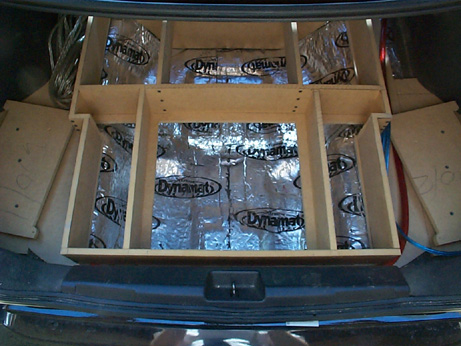

I braced this enclosure all I could w/o sacrificing too much airspace. It's for 2 ported Diamond Audio TDX104's in the spare tire well. The bottom is fiberglassed now.
