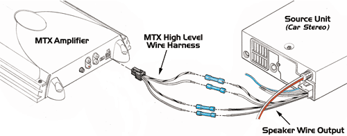

Some amp manufactures provide speaker level inputs and have no need for converters

my amp came with this cable, which i did not use, i used the rca's instead that is a little plug with 4 small wires from it, could i use that and skip the converter or would i still need it? and where would i connect the REM wire for the amp at?
