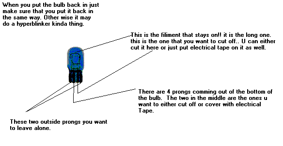

Ok!! here ya go...
Old Mar 4, 2004
02civic_rida's Avatar
iTrader: (28)
Posts: 2,976
From: Orlando
Rep Power: 307
Jackscivic is saying it correctly... however, i know that a pic might help ya out,, this is ghetto, but hey, im at work and im not supposed to be on here and i still did it... WHy.... Cause im a gangsta a gangsta , uhhh!!! LOL
NOw, mind you, our bulbs are white. But that should do it... IT IS SO EASY

yeah one of my taillights went out yesterday. i bought some 7443 bulbs. tried to put them in, they wouldn't fit. i realized i needed 7440 actually. comparing the 2 bulbs, i figured out which prongs i needed and bent off the other 2 in my car. bulb fit like a champ. dunno what all this sanding talk is coming from...

I have done the same to my car a long time ago but I took a different approach.
I took some 7443's and bent the 2 inner wires to be parallel to the 2 outer wires. That way, when I turn my blinker on, both filaments light up. That's how it is stock, and is brighter. My blue bulbs blink white instead of blue.
