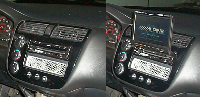

Harness goes from deck plug to a connector in the pass. kick. Then along the floor board to rear pass. pillar and plugs into ant. amplifier box. (Check plug on it also.)

I can't believe so many 7thgener's are having this same problem regardless of the HU brand. I been had this problem for 2 years now but since I only listen to CD's is don't matter, but I like sports talk radio too. Instead of doing all that prong stuff though can't I just connect the power att. wire to my relay and just send a signal to it like that?

I think it really depends on the HU. I have the IVA-D900 alpine and mine works fine.
