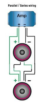

Ok, I will be getting the Alpine MRD-M500 Amplifier (stable at 2 ohms) and the 2 Alpine SWR-1021D 10" Type-R 2-ohm DVC Subwoofers. Is the wiring diagram (attached below) the correct way to wire this setup for a combination paralell/series connection as regularjoe suggested? This will power the subs at 2ohms each, which will draw 250 watts each (amp is rated 500wRMS @2ohms), correct?

that's the right wiring. don't mind the impedence the subs are at, the subs will each get 250W. the subs are actually at 1 ohm, but you have 2 in series, so the amp sees 2 ohms. get it?
