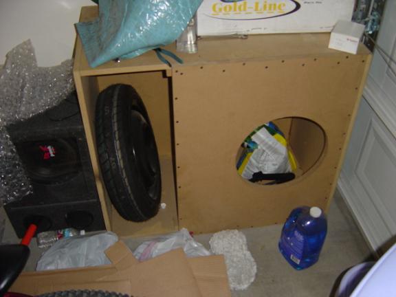

you shouldnt waste airspace on the lower end subs..you should probly just build the box as huge as possible for one or two of the 12s with a bunch of port. i have a box that will fit in our cars...face is built for one 15 though and u cant have a back seat. and u need to take out both seats and the center console to get it in....oh...and unbolt the Ebrake also.....but your more than welcome to use it.
Posts: 389
From: Phoenix, Arizona, US
the subs are awseom for both spl and sq. thats why i have all four, and plus subs are made for different purposes. its not all about how loud you can thump. if you can't hear the different tones its just a waste of money. thats why there is more money in the sq competitions than in spl
