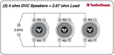

what's a good way to wire my subs to my amp?
I have 1 boss amp 1200 watts and 3 audio bahns pushing about 400 watts each?

I had the same setup not too long ago. Those audiobahns are a nuisance. The wire leads kept burning off, and I had to repeatedly solder them back together. Well, anyways the best configuration for you with dual 4 ohm voice coils is.....
Wire both voice coils on all 3 in parallel. Then wire the subwoofers together in series. This will yield you with a 2.6 ohm load. Your only 2 choices are that or wiring everything in parallel, but that would give you a .66 ohm load. I don't think any amp exists that can handle that kinda load.
For more information, you can consult www.jlaudio.com , and click on tutorials, and how to wire your subs. good information.
Actually do exactly the opposite what Azn said.
If you wire them all in parallel you'll have (3) 2 ohm loads and when you wire in series you'll get a 6 ohm load.
What you need to do is wire all the subs in series first so you get (3) 8 ohm loads then wire them in parallel to get a 2.66 ohm load.
Just hope the boss amp is stable to that ohm rating. If its truely a monoblock amp then the word "bridged" should not be on the spec sheet.
If you wire them all in parallel you'll have (3) 2 ohm loads and when you wire in series you'll get a 6 ohm load.What you need to do is wire all the subs in series first so you get (3) 8 ohm loads then wire them in parallel to get a 2.66 ohm load.
