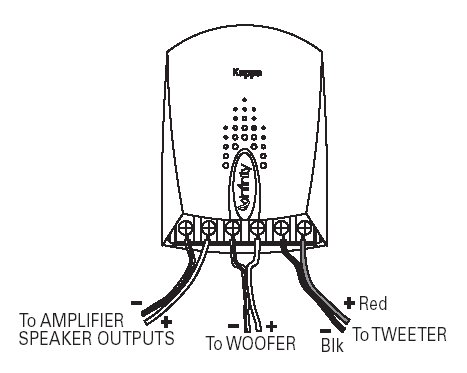

I just bought some infinity 60.5cs component and my causin gave me a 4 channel Hifonics 4x50w mosfet amp. OK here is the question, how the I wire the components and the tweeters so that each channel on the amp is hooked up to a speaker and tweet. It probably is easy but the crossovers and the 2 RCA's are confusing me, someone please help

Check this out. Do this for each side...left and right. This pic is actually from a Boston Acoustics pdf, but it's the same orientation as your crossover.

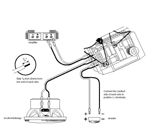

Here's the pic from your Infinity manual.
