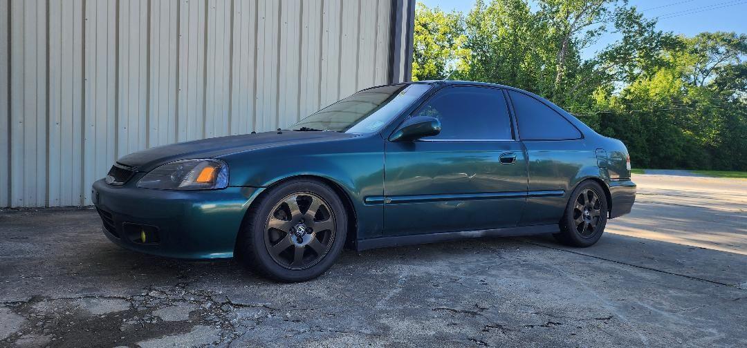

I'm not a 9th gen, but I just lowered my car a couple months ago and used skunk2 coil overs, front skunk2 adjustable upper control arms/ camber kit and rear skunk2 adjustable camber kit. I didn't go really low, and the ride isn't bad. I had it aligned right after and no issues.
