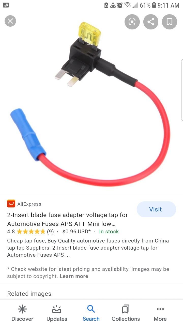

Either run it to an interior power source like a "cigarette lighter"
or
Buy a fuse adapter (shown below), plug it into a fuse in you interior fuse box.
theres only one wire because this is a positive tap, you can ground to any metal part of the car connected to the body (look for bolts going through the frame).
