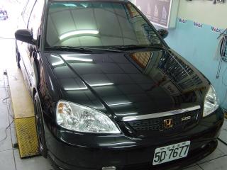

In taiwam HID bulbs have many young guy change this stock...
because very "cool"..just like you say "like angel eyes...
i don,t like because too explene...taiwam HID NT$18000..oh my God
