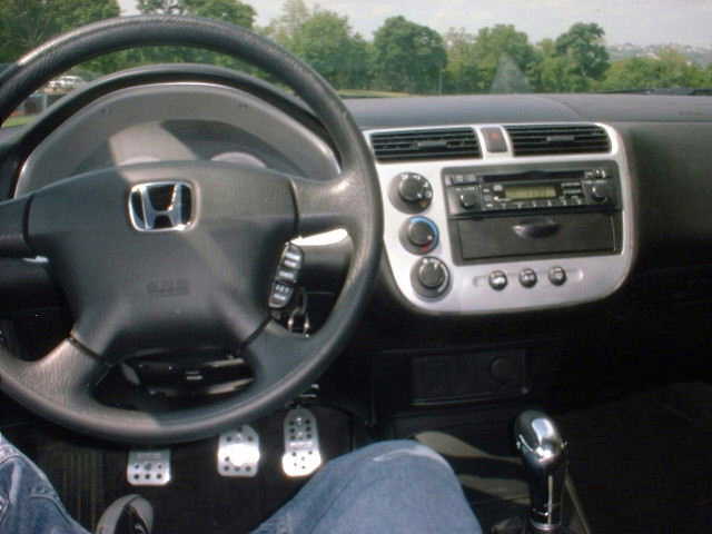

I got my Trim pieces painted last weekend when I installed my exhaust, so let me know what you think

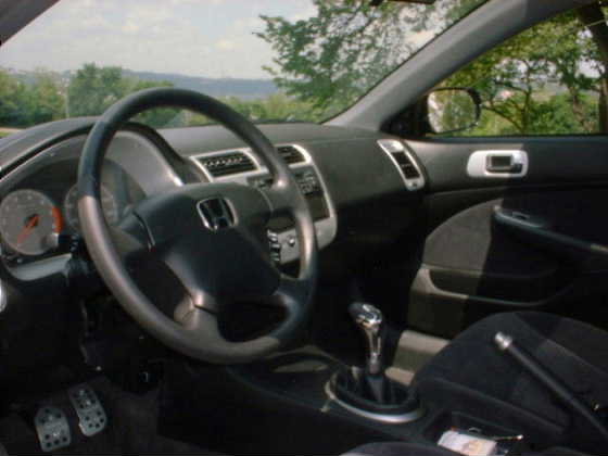

here's a better picture straight on, sorry bout the gritty look to the pictures, it was the only way i could attach'm

looks good
