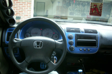

i was thinking of doing this down the line, too. anyway, i just thought i'd do it this color if i found it (down there). silver is cool (and my car is SSM), but i'm going for a silver/blue theme anyway......
and has someone answered mos_skeeto's question about the painting technique? i want to know how to spray the paint on. thanks
