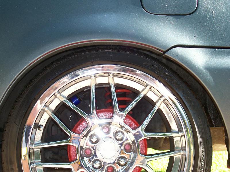

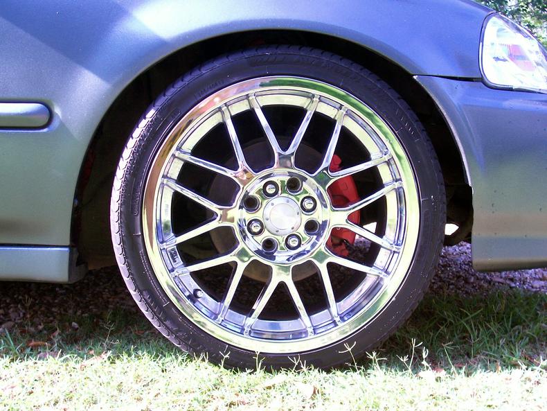

i got the megan racing adjustable upper control arms for my 97 ex coupe. it ran me about 100 dollars. They are adjustable for stock, up to 4 inches of lower. My car is pretty low as you can see, my fender eats my tire and megans work great! I was having an issue of serious tire depletion on the inside edge. My $150 each tires were destroyed after 10,000 miles. If you lower, you need a camber kit. Go on ebay and type in this item number :180375392161.
