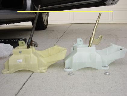

how much shorter is the shift lever on the Revo SS compared to the stock shift lever? thanks for the help.

1 1/4 or 1 3/4 inches. There is a picture somewhere. You probably can find it searching

capyoda has a picture i think, comparing the two shifters side by side.

Its not the shortness of the stick, its the distance of the hanger for the shifter cable. You can see in the picture that the piece that comes out from the shifter is higher that the stock, thus the shorter shifting distance.

i think it says on the site that it is 1 1/2 shorter and reduces throw by 40%.
