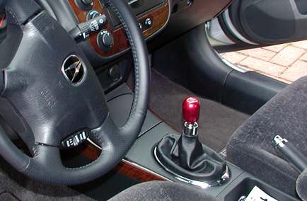

No it doesn't. Then again, I picked up and modded a CTR shift boot to fit, and it's plenty stiff so it doesn't fall down - there's like a 1-cm gap between the boot and the bottom of the shift ****.
However if you're gonna go with the stock one, what I suggest doing is what I did when I had the stock boot and a cheap replica type r ****. When the centre console was off and the shifter installed, I took a couple of thick rubber bands and wrapped them around the shaft on the shift assembly, to hold up the boot by the collar. I then installed the console then the ****. It held things up nicely.

Here's a pic of my old ****/boot combo. As you can see the rubber bands did a pretty decent job of holding up the boot.
