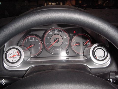

I wouldn't get it. It's not designed very well. Here's a pic of an EX. I also have a pic of the newer dash, but I'll have to attach it later when I'm at home.

Here's the pic with the newer dash.

He has 03 ex so I guess it will look ok.
Old Sep 30, 2003
sexcivic2k1's Avatar
Posts: 2,760
damn! i just saw the pics! this totally sucks, i dont want my gas gauge blocked or my heat!
