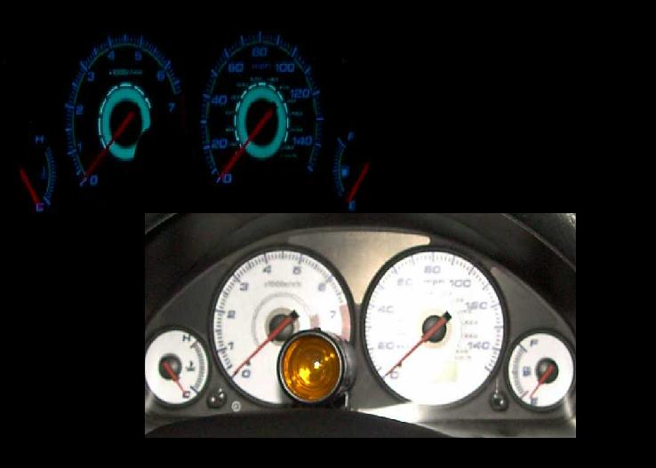

you could do this
dave1847 's car btw

I like that that is actually pretty cool.

Wat exactly is that??
I'm not sure wat it is?

dx gauge cluster with air temp gauge and tach.

that is very clean, kinda wish I had a cheaper cluster. so I could do it too !
props man!

Wow how did you do that with your cluster and where did you get those pieces to show the digital display??? That is the hottest thing I have seen in a long time.
Old Oct 4, 2003
evol's Avatar
Posts: 386
From: sin city (Las Vegas, NV)
evol is an unknown quantity at this point
you can find gauges like this here
http://www.dakotadigital.com/
