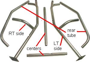

i saw some roll cages and roll bars for our civics on ebay this week. does anyone have one? what is the difference between a roll cage and a roll bar? here are the pics.
roll cage. anyone know how this would go together?
roll bar

A cage is gonna run down the front pillars and fully encapsulate you. There's gonna be a square frame on the roof and probably some diagonal members across the door openings. A roll bar, is exactly what it sounds like... it's just a bar behind the front seats that keeps the roof from coming in if you roll. As far as that cage going together... I wouldn't do it any other way but welding.

wait a minute here.. those pictures are exactly the same. you have to get a little creative and look at all the bends...but every peice is the same. hope they are about the same price. oh and for looks they are cool and maybe for mounting a camera... but you will have to do alot of work to your ride if you are ever going to go fast enough to need a real cage.

Your right, they are the same, just one shows the un assembled pieces. Whats shown is a roll bar, good for the street/autocross/track days. I dont recomend a roll cage for the street because, unless you have a habbit of wearing a helmet when you drive, haveing a roll cage can be VERY dangerous (they can cause Major Head injuries even in minor accedents).

and though I would reccomend welding it in also ... the solid kit shown a bolt in kit... you can see the welded nuts plain as day

dude ... did you read what it says about these... I really hope you dont buy these and think they are going to save you in a roll over

hahahah.... they are made by APC!!!!!!
Add racing style to the interior of your vehicle with APC Show Tubes.
This would be much better (Autopower makes good roll bars and roll cages)

cross bars... ohhhhhhhhhhhh,, ooohhhhhhhhhhhhh... excuse me whilst I change my soiled pants .

those are just for show, the tubing is way too small to make any difference if you roll.

If you want a real roll cage/bar, get a certified welder to do it for you. They will know what metals to use, and where to mount them. A cage for my car, custom built would cost me about $80 in tubing. This is only a 4 point cage though, nothing exquisite. Those APC cages and Monkeybars are for nothing more than show. Their for those more interested in looking fast than driving fast.
