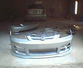

Man, I had identical problems with my kit from aerotrends.com. Had to grind out a little spot by the corners of the headlights. Had to Duraglass the holes. The part that kinda hangs down we cut out and replaced it with the honda factory grill piece. Also, hope you are making some kind of bracket to hold the front and back bumper in place...The four screws (2 under the hood & 2 in the tire well) isn't enough if you drive fast. If you need pix I can take some and post them here. I have my front bumper off because we are painting the whole car again.

i had honda put in more screws in the wheel wells casue the mesh on the side vents was tearing my wheel well a new A hole. and i have been driving it 100+ about daily
oh and the piece is poly urathane
