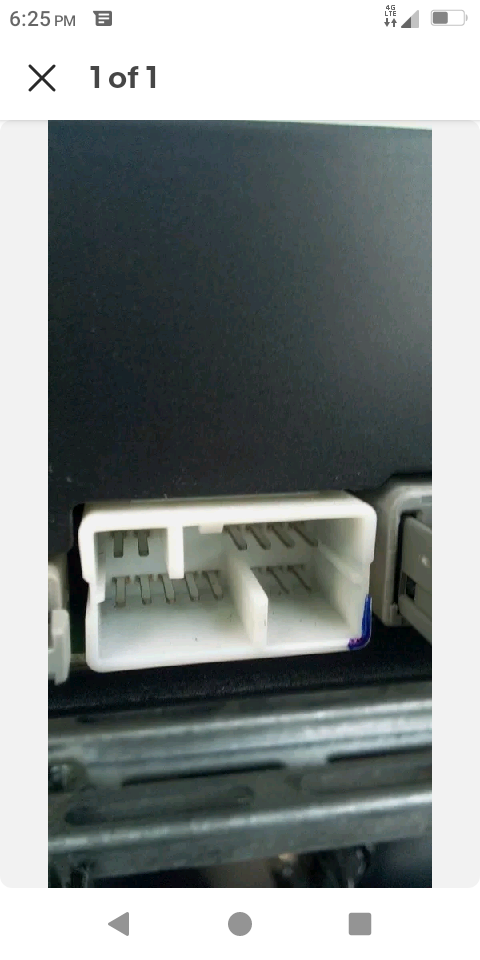

My soon to be driving son hoped to add an Aux cord to his stereo. It's the stock stereo, no nav. I'm not even sure it's possible. There's one free port on the back. Pic attached. I'm also attaching the info off the head unit. I can't find a connector that fits the free port. Maybe I need to use the other port, but it already has something plugged in. Could someone let me know of any options?

Bluetooth FM transmitter is an option. If that one has a cassette deck (I don’t know if they do), there’s a dongle that you can purchase too that plugs into it and has an aux cable.

Crutchfield has adapters that plug into that port on the radio and allow for bluetooth connection.
https://www.crutchfield.com/g_356850....html?tp=68488
