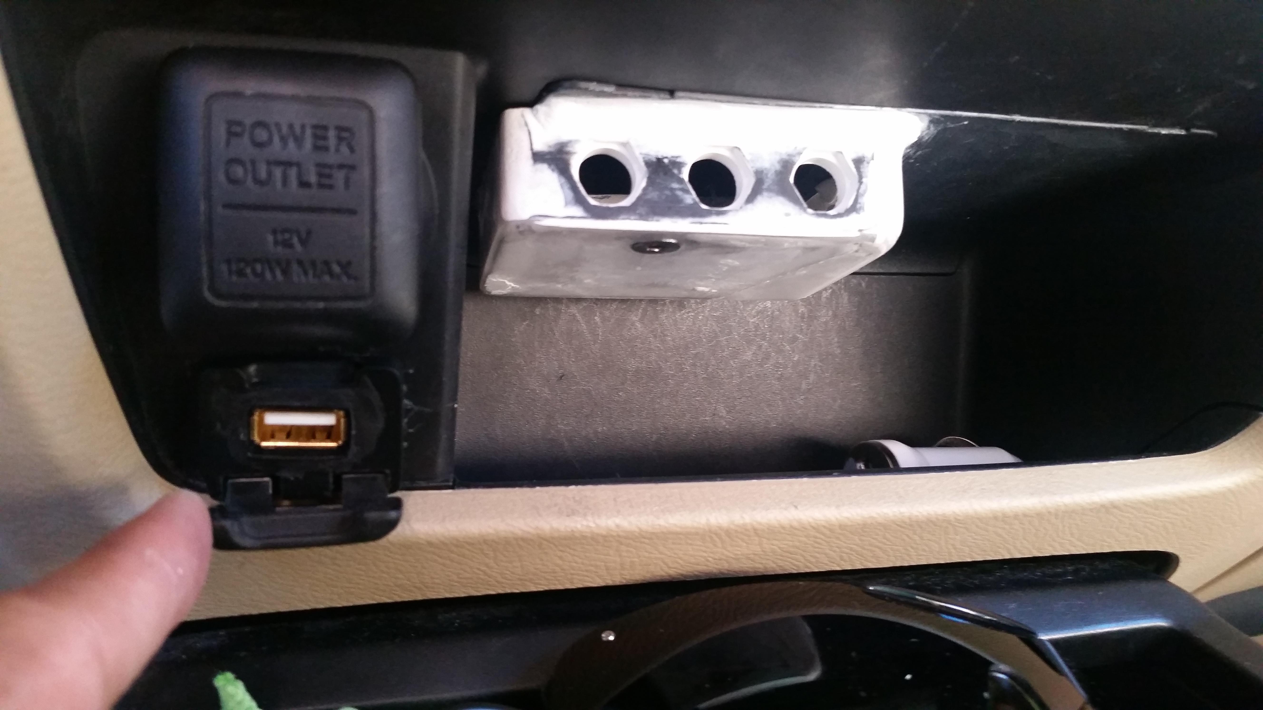

I did it on my ex's 08. Her OEM aux input went bad, and we got a pioneer in-dash navi unit from her godfather. Instead of buying a new aux jack, I gutted the OEM aux input jack and carefully carved out a hole to accommodate a female USB plug. Used plastic weld putty and paint to make it look OEM, and still retained the little spring loaded flip door.

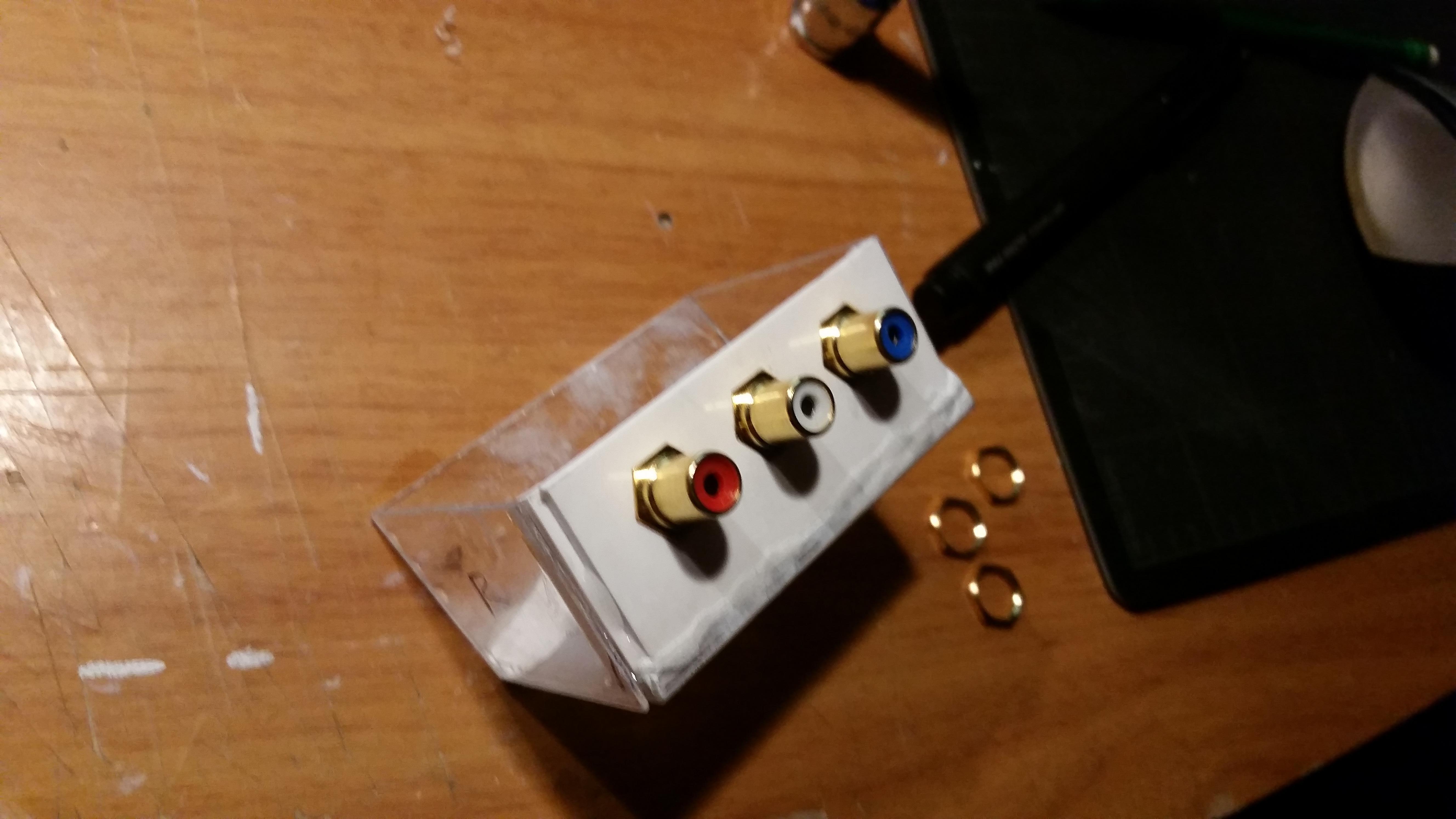

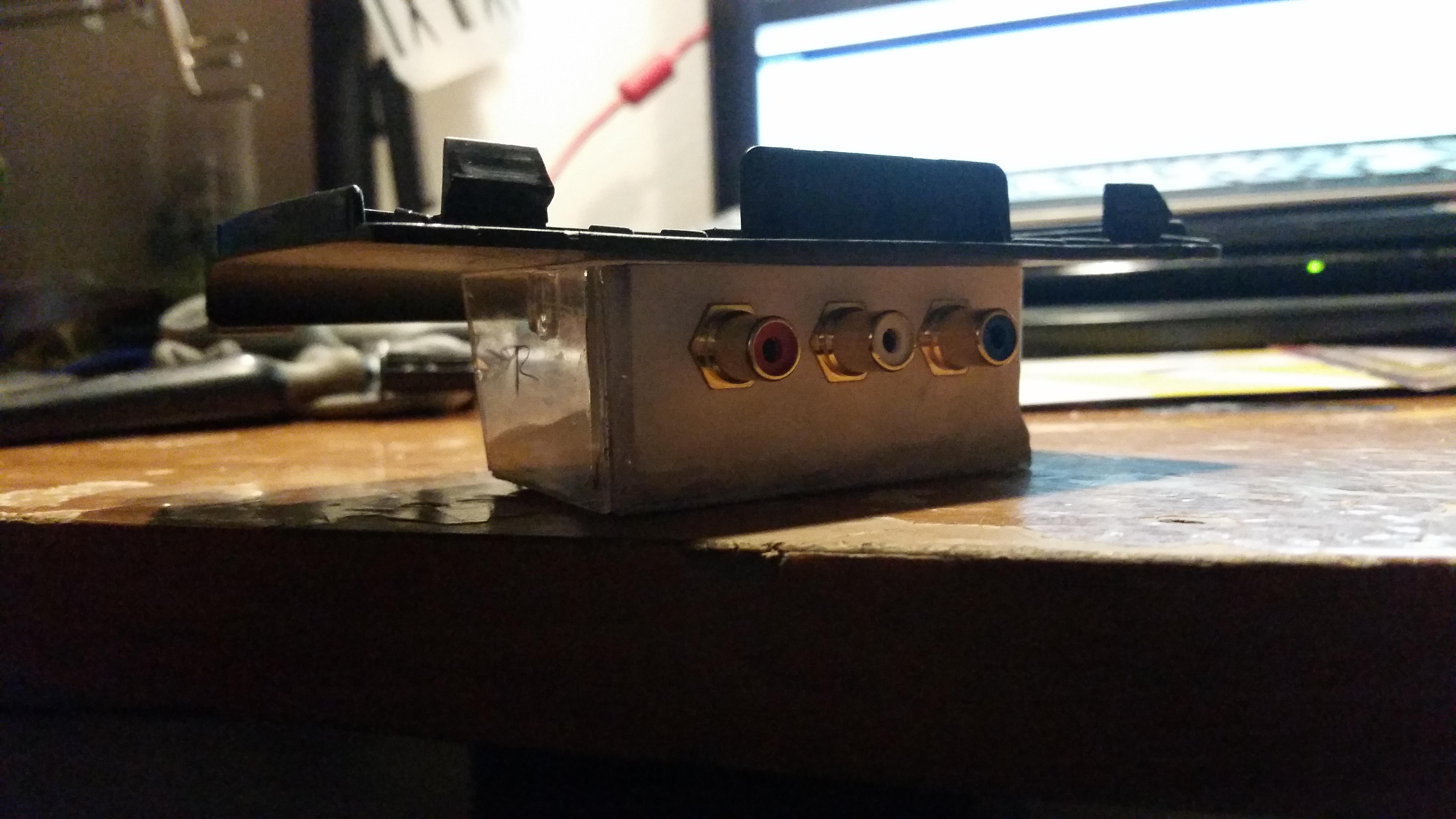

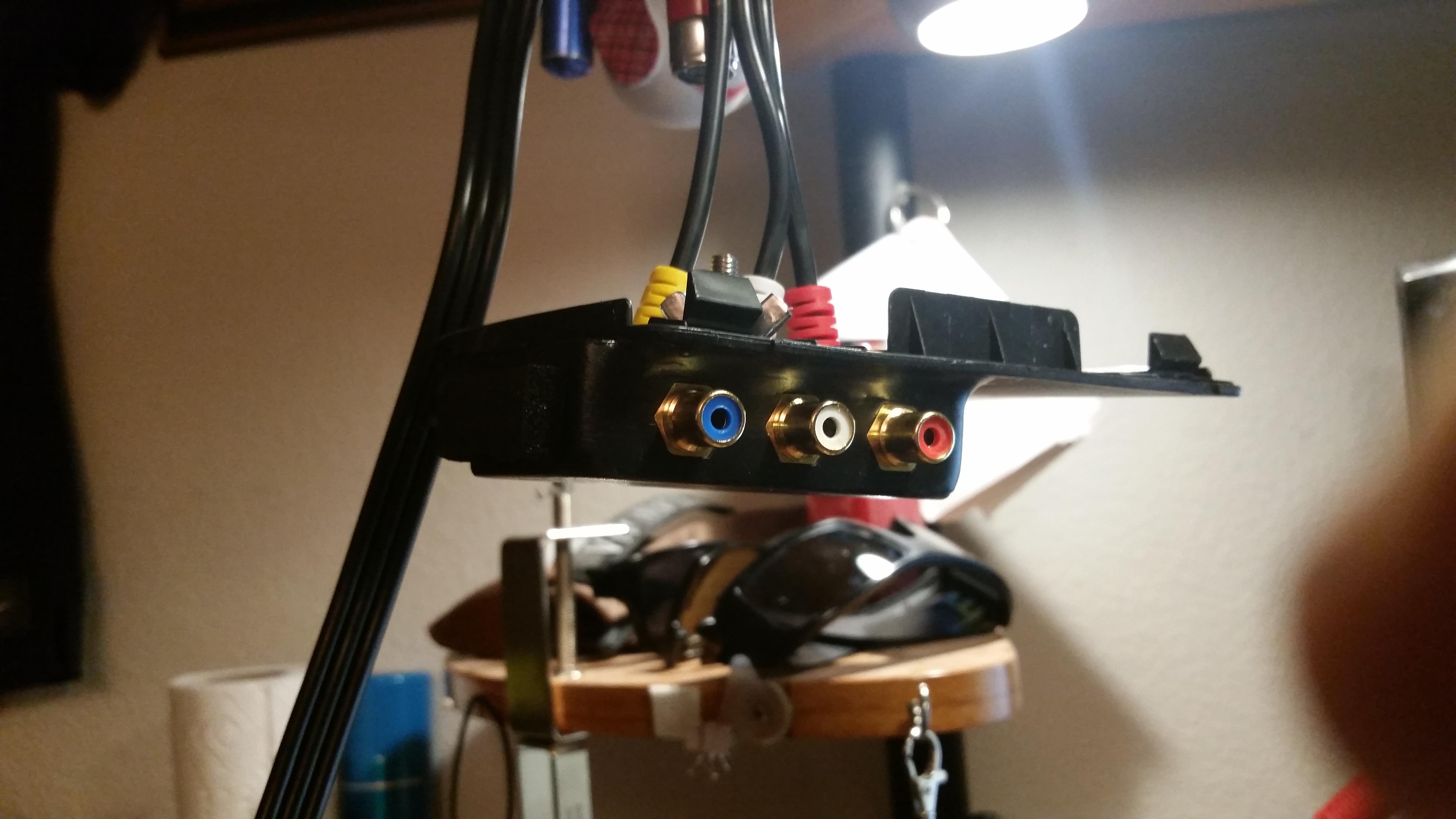

Since the pioneer accessory that came with it also had the capability to use RCA inputs (for video, another aux audio, etc), I made a plastic box from sheets of scrylic that mounted to the top of that little pocket. More paint, plastic weld putty, and lots of sanding to look like it came like that. She also has a 3.5mm jack to RCA cable to plug in any other device like her android phone. iPods play from the usb jack just fine.
I'll see if I can find pics, but I don't think I saved any.
edit: scoured my imgur pics and found some, mostly of the plastic box I made, one that shows the USB jack. You can only tell the plastic weld (or maybe it was sugru.. It was prolly sugru) is there in person if you look closely at it.

lots and lots and lots of patience. It was an ugly oversized hole before I used that sugru stuff to make it look pretty. If you haven't used it before, it's moldable silicone glue, kinda has a slightly crumblier play-doh texture before it cures. I used an exacto to shape it
gutting the aux jack to fit the USB was, by far, the hardest part.
