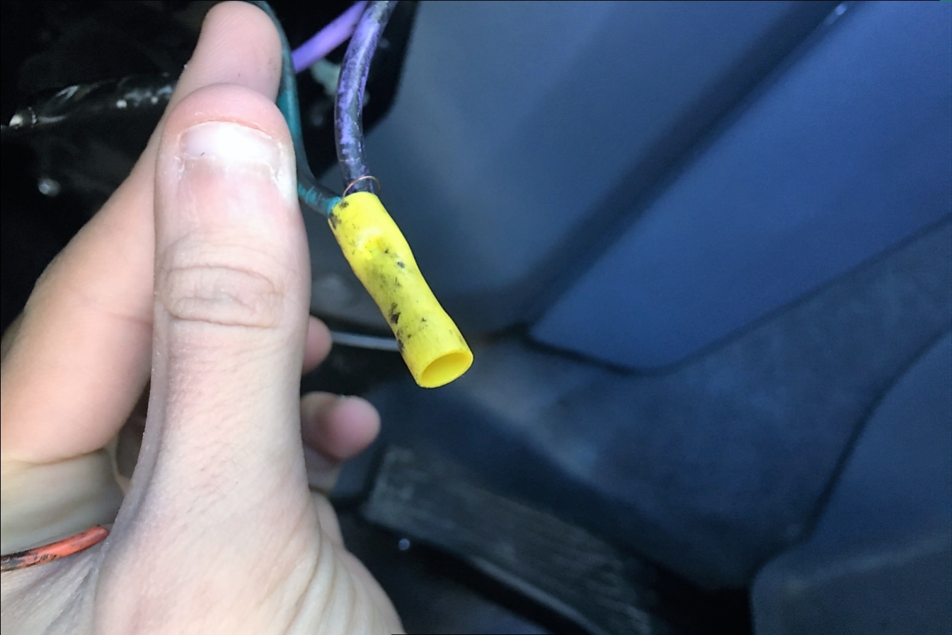

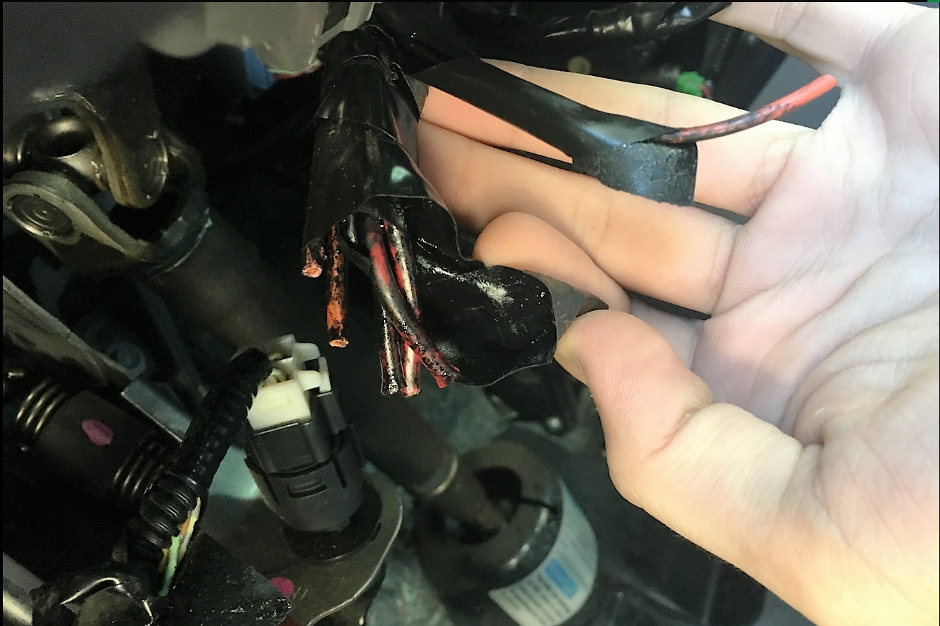

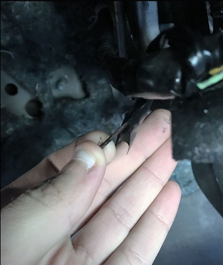

I just bought a 2010 Honda Civic LX four door and I have some questions about the wiring. The car runs perfectly fine but there's some wires that are cut here's some pictures below. Can anyone tell me what these wires were originally for? Overall, nothing is really wrong with the car starting up or driving or gauges but I'm curious as to what I should do about these. Should I get them removed or just leave them how it is?
First picture has some sort of brown or dark red wire. Second picture has a turquoise/green and purple wire connected together but not going anywhere. Third picture it has a couple red and orange wires just cut
Can anyone tell me if I should be concerned or it's some sort of alarm system or remote start that was removed?

Follow the taped up bundle to a control unit (probably 3"x3" black box or so)
I'll guess it's probably from a remote start that's been disabled.
If it's not causing problems I might leave it alone.

Ok I'm just curious as to what these wires could be for. Nothing effects the driving or starting of the car I'm just curious as to what this mess of wires is for. Because I have 1 speaker not working and the dome light and lights by the rear view mirror don't work.

The dome light does not work at all. Sometimes if I close the door and then I open it it will be on for a couple seconds. I think it's a loose wire.
Here's more pictures of the wiring:
So turns out the purple wire turns into a yellow wire:
https://gyazo.com/eefe117090b2111ff9ee5fc8332fa9af
Turns out following the wires up more they all come into one big bundle all together connecting to something inside the steering wheel and then running up through the car upwards somewhere:
https://gyazo.com/df56cd0b9c441d8be76979ddb7b0414e
https://gyazo.com/f6ee14d273858c660d44eaa4c5680fb4

Large gauge wiring tapped into the ignition switch harness is almost always for remote start.

I have a remote starter mechanic in my town. Should I have him remove the wires or should I just wrap electrical tape around them and leave them alone?
