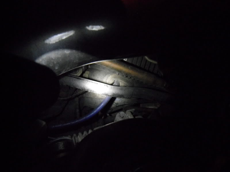

I went through the firewall on the passenger side using an existing grommet, under the passenger side doorsill, behind the rear passenger side plastic piece, and that feeds right to the trunk
as for your remote wire, just find a +12V wire that is hot when the key is in the accessory position
I was standing just forward of the battery looking down into the engine bay for this shot. The grey shiny piece at the top left of the picture is my intake, for reference.
