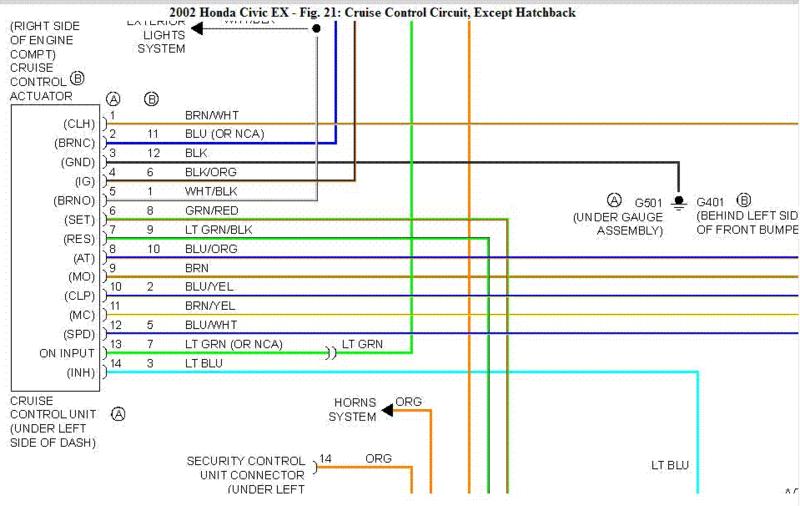

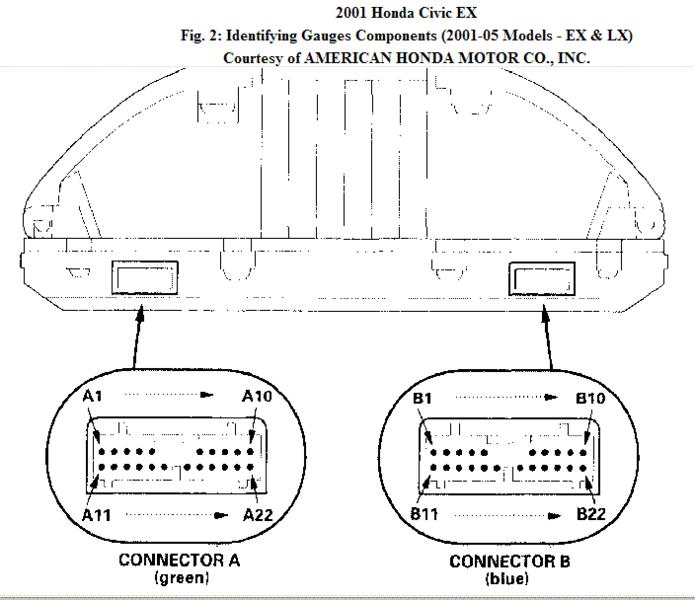

I attached a diagram of the cruise control unit and the instrument cluster. You can find VSS at either one or the PCM I mentioned earlier. I'm not entirely sure but I'm getting the impression the EX doesn't have a cruise control unit under the dash, it's only the cruise actuator @ the passenger side engine compartment. VSS is labeled as SPD on the cruise schematic. You can also get VSS at the instrument cluster, it's blue/white and you might be able to get at the harnesses from underneath.

Originally Posted by jbrown59
I just opened the cruise control panel and no white and blue wire. The wire colors are 2 black wires, 1 black/red. 1 red and then a light blue wire---which i think you were describing. Also, is there any other way to tap power without going into the ignition harness like using the cigarrette lighter power or some other way or do I have to unwrap the harness and get those wires?
Scratch the last post , light blue = INH, Im going to try to find the wire right now, maybe ill post pics up to make sure Im hitting the right wire.

But those wires don't match, are you sure you're at the right spot? The schematics are for an EX.

Re: Wiring Problems w/new pics
So that last picture is def your cruise control switch but you won't find VSS there. Your best bet will probably be the cluster. I included a graphic to give you an idea of where the harness is plugged in that you want. You want the blue/white wire at pin A12 in the green plug.
