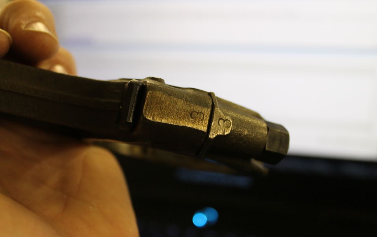

I spun a bearing a need some help been looking online but cant find the right code on the block. the engine is still in the car so its not easy to see, but need to find out.
I have the bearing out but what I need is to know were the code for the journal is on the block so can order a new bearing I have the code from the rod its 3, if anyone can let me know or send me a pic that would be sick.
um.. curiously, are you calling the 3 stamped on the rod a code and looking for a crank journal code?
can you post a good picture of the crank journal? i'm interested to see how smooth it is. i've never seen a journal that had a spun bearing be smooth enough to reuse. most fail again, and quickly.

There's no way the dealer can find out what bearings the engine originally had in it. Someone needs to check all the ID codes on the block, crank, and rods.
Forget dealer bearings for now anyway.
If it spun a bearing, that throw on the crank is wasted. Crank need checked and machined if possible.
If it spun a rod bearing, that connecting rod is also wasted and needs replaced.
If it spun a main bearing, the block journal is wasted but might be fixed with align boring (line bore).
Drop it all off at the machine shop, have them work their magic and get the right bearings that are right for whatever they machined.
Or drop in a good used engine?
