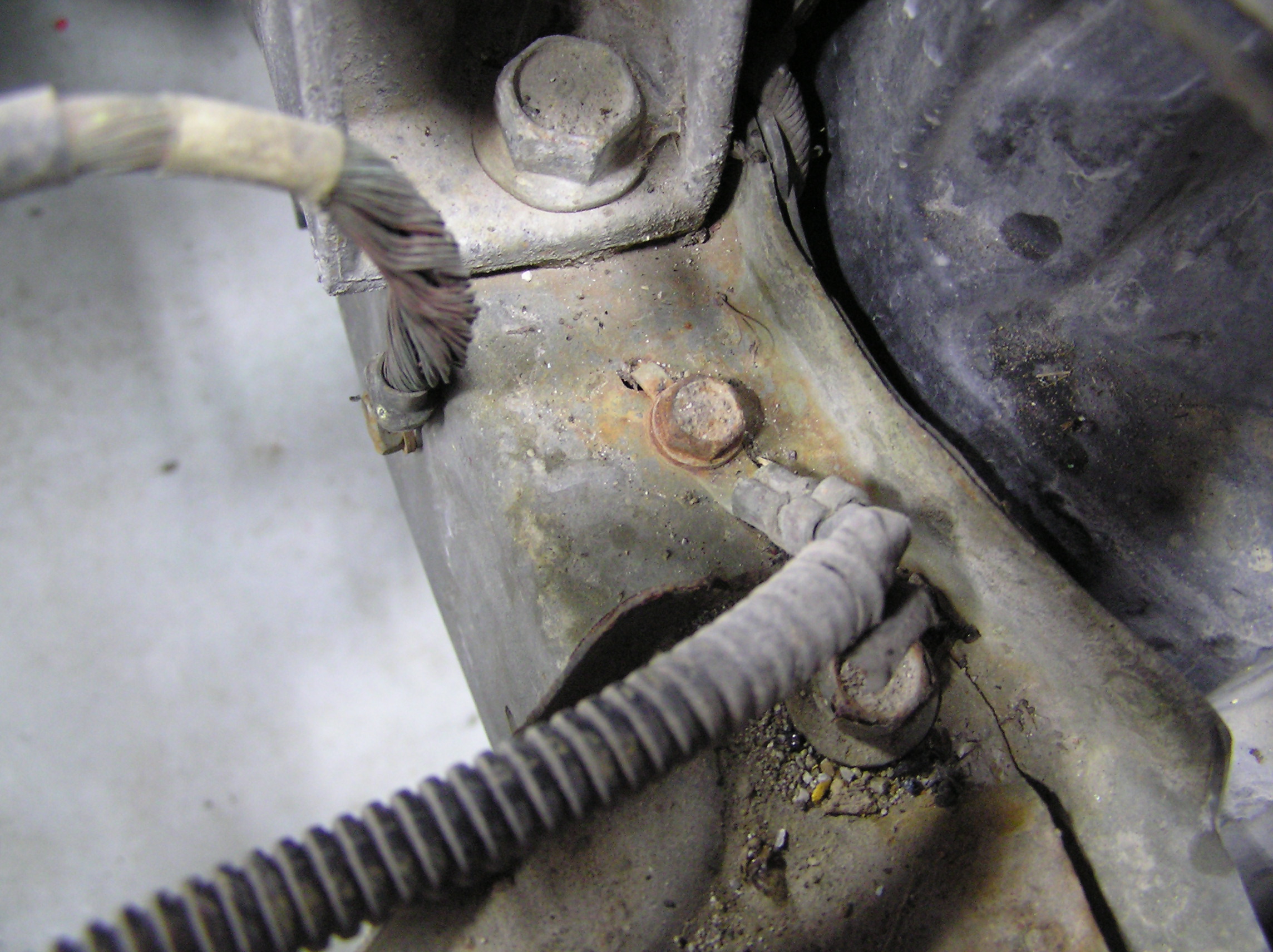

Old Apr 11, 2016
Re: Intermittent slow-cranking (with video)
Originally Posted by Dorval Andre
I'm trying to google the various ground connections to check
Battery neg cable goes down to the body
A couple inches away from that is a cable from body to transmission
(see pic below, both connections can get pretty cruddy with corrosion)
Another cable runs from the passengers strut tower area to the engine mount
Old Apr 11, 2016
That's hilarious lmao
I will see if I can find a bad / loose / corroded ground and hopefully not have to try and find parts-cannon artillery for rent here in Montréal
Thanks ezone
