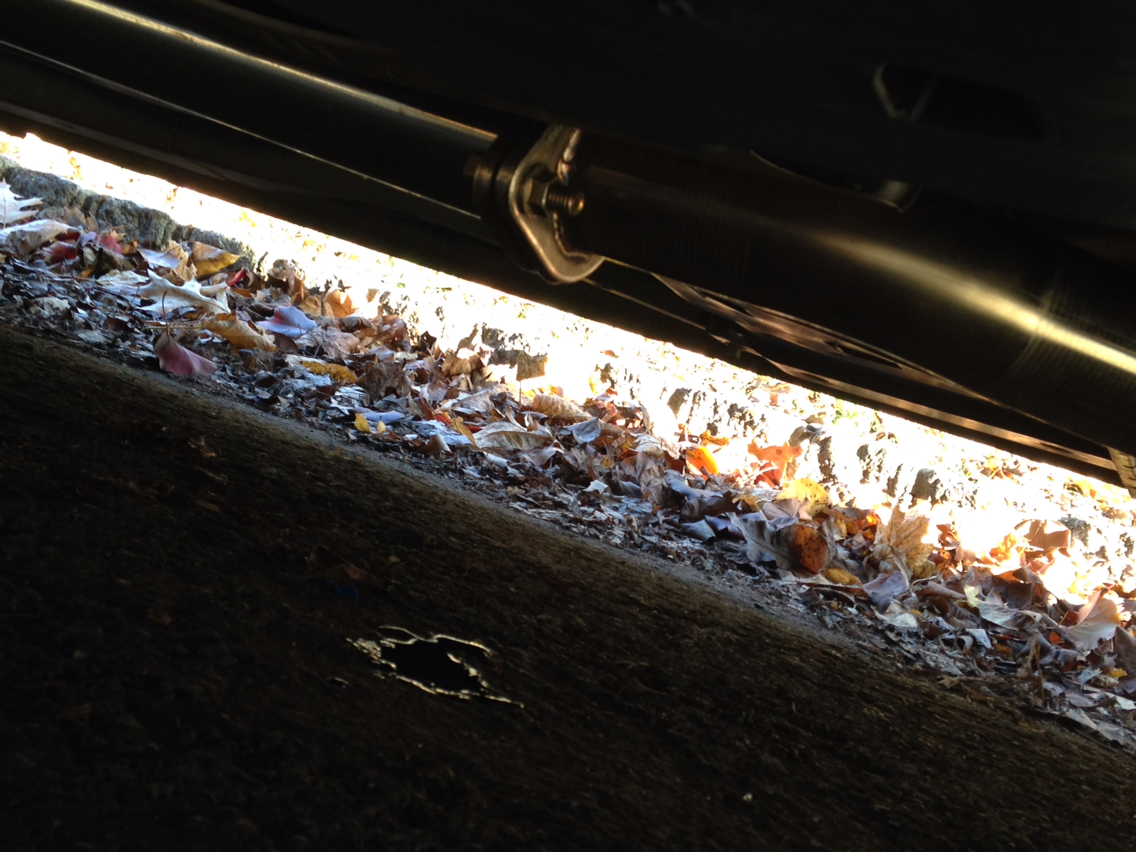

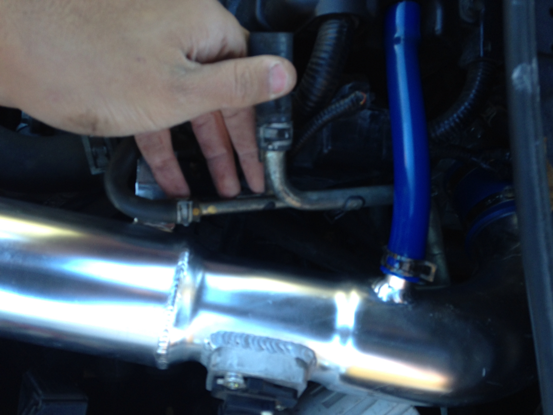

Should my exhaust be doing this and could it be the reason I'm getting a fuel too lean code, it's also doing the same thing from the triangle shaped gasket in my exhaust and what do I do to this hose I know it's not supposed to be open ended like that so I'd really like to know what I need to buy to fix it, the intake kit never came with a hose to fit that

Pic1 exhaust has a small puddle under it? No biggie IMO. Water is normal, but the joint is leaking a bit.
Not the cause of your code.
I can't tell what the other pic is other than the breather vent. Too close. Where does it go? Is it still connected to anything other then the water lines?

I've attached some more pictures, hopefully those will help, I have no idea what the hose is running to or what it does I'm just trying to troubleshoot this engine light as I currently have a 1000 mile trip to make. I'm going to go tommorow and look at the exhaust some more, it is leaking badly I can feel it and hear a hissing noise coming from the unde the car,

P0171 ----Remove MAF sensor from the breather tube
Get the flashlight and look for dirt/debris/bug stuck in the MAF sensor.
On a stock system this seems to happen when one uses a cheapo air filter that doesn't fit quite right or someone mutilates the rubber gasket around the filter.
With CAI it's anyones guess. Also check if the filter is the oily type that it isn't saturated and contaminated the MAF sensor.

Is the vent port on the valve cover open-- or not connected to the intake pipe?
Got the stock air filter box? Reinstall it, erase codes, then see if the code returns?
