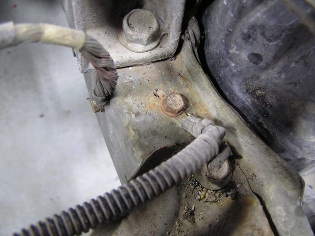

Are you running 5w20 oil or even 0w20 oil? Anything thicker than 5w20 needs to get out of there.
A super cold engine can require twice as much power to crank, while a super cold battery may only have half of its power available.
Any little issue can suddenly become a much bigger problem under these extreme conditions.
Ever do voltage drop testing?(damn hard to reach the pos cable end at the starter though)...Google it
Measure amp load of the starter?
Replaced the starter yet? Seems like many people have replaced these for various reasons.
Cleaned up the ground cable connections yet?
Follow neg cable from battery to body, disassemble and clean/wire brush/sand/file/etc. to bare shiny metal-- terminal, bolt, and body for good connection. Coat in dielectric silicone grease for protection.
Repeat the same for both ends of the short cable next to it, goes from body to transmission.
Stack the two cable terminals right there on the same bolt if there's enough room?

Still original starter, funny thing, starter was my very first thought first time. No garage available to me to do drop test, so I have an appointment tomorrow night at a garage for them to do it for me.
I'll get this done at the garage at the same time.
Thanks for all the assists man, really appreciate it.
