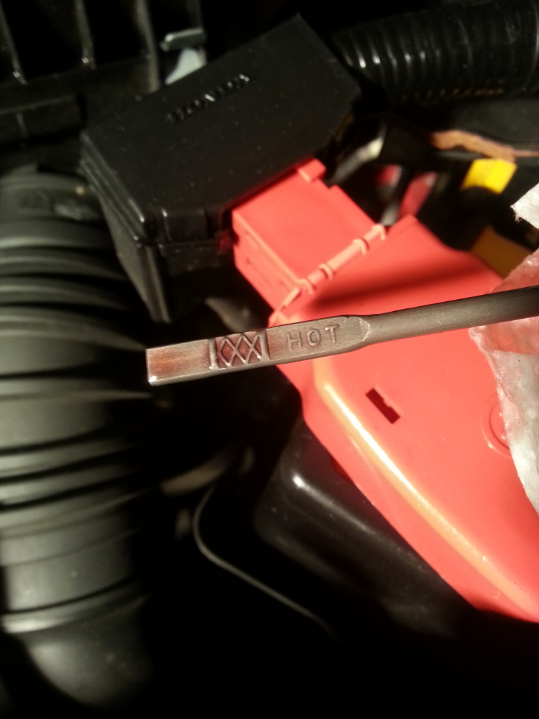

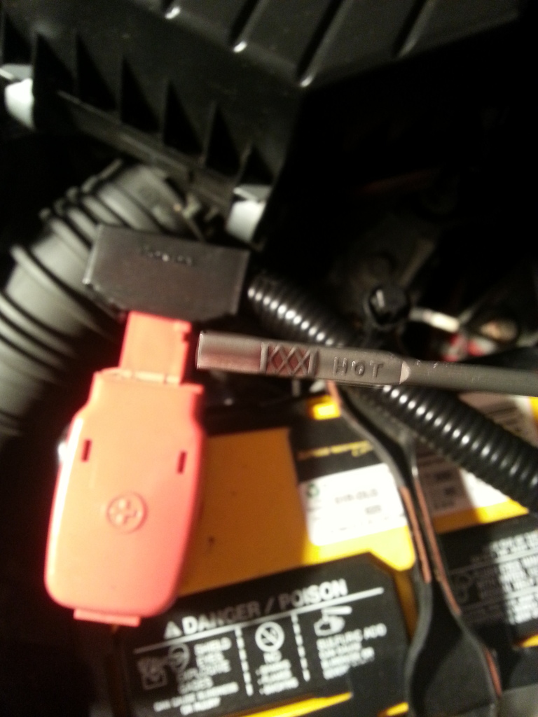

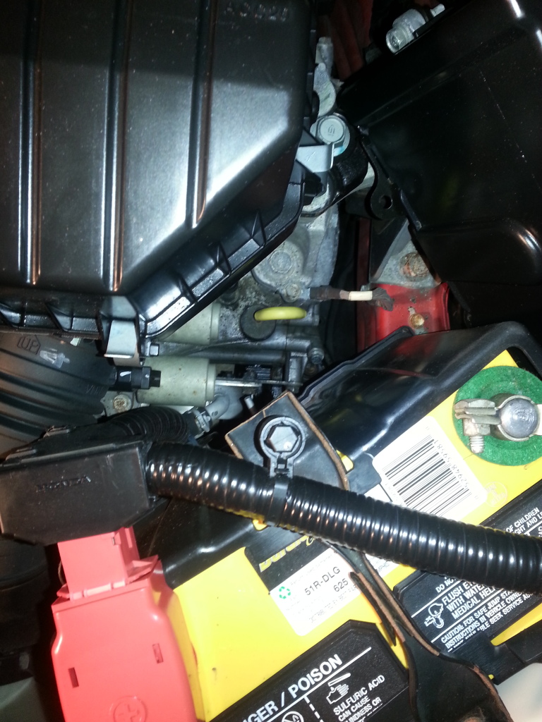

So I recently purchased a 2007 Civic EX coupe with 83k miles and I'm currently in the process of changing the automatic tranny fluid 4 times to get all the old stuff out. I ended up filling it up with about 2.6 quarts the 1st time and 2.7 the second time because that's what I measured coming out. I noticed that depending how the dip stick is facing when you insert it it gives a different reading. Having the dipstick placed in this position I get a reading right at the top line every time I insert it, as can be seen with the pictures...

But inserting the dipstick in this position it sometimes comes out way above the limit, with the level literally touching the "T" in the "HOT". It's hard to see how far it's over on this pic, but it is touching the "T".

Sometimes though it does come out the same way as with the other position, reading right at the top line. Which level should I trust? Should I go by the lowest and most common reading, or the overfilled reading it sometimes shows on the certain positions? I am doing all readings on a level ground as well.

Check it with the engine off, and between a minute and 90 seconds of turning the engine off.
Your owners manual should tell you how to do this. Page 230.
From your manual:
Check the fluid level with the engine
at normal operating temperature.
Park the vehicle on level ground.
Start the engine and let it run until
the radiator fan comes on, then
shut off the engine
. For accurate
results, wait about 60 seconds
before going to step 2, but don%u2019t
wait longer than 90 seconds.
If the engine is running it splashes the fluid around.
If you don't wait a minute, there's still a lot of fluid dripping inside.
The stick is supposed to measure the puddle at the bottom, not the fluid dripping off the sides.
When you insert the stick one direction. you can brush against the surfaces inside (look down in the hole- you should see what I'm talking about) and that can give misleading readings, depending on which side touches.
Turn it whichever way you need to so it doesn't do that.
I always go by the lowest fluid reading I can find after the stick has been fully inserted. Not the highest.
If the fluid is cold, don't fill it to the top of the dipstick because it will be overfull once the fluid is hot.
OTOH, I frequently see these where someone has just dumped the entire 3 quarts in. No issues really ever noticed.
HTH
