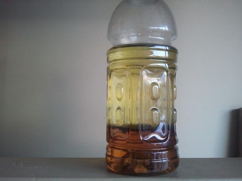

How did you find it? What did it look like?
Post a pic of the clear jar? Maybe with light behind it or something?

Here ya go! (sorry it's not a "clear" jar)
Gas station owner:
"Yes, we had a problem. Have it towed to where you want it fixed and bring us all the receipts."
What should I make sure the shop (I'm 50 miles from the Honda dealer) does to make sure I get the most life out of what's left of this car. The car looks 4-5 years old like it should, but has 213K miles on it. I was hoping for another 3+ years before I pushed it off a cliff, or gave to someone less fortunate who could use 'transportation'.
Thanks,
D1

Good for him, he's ethical. Probably has insurance that covers events like this.
The tank needs to be drained completely, and I don't mean just run the fuel pump until no more liquid comes out (there is still a significant amount of gas the pump can't pump out). I mean DRAINED. If they have to pull the tank, do it. If they can get in there with a straw and suck it completely dry, that's fine too.
But if there is sediment or crud on the bottom of the tank, it needs pulled and cleaned.
Purge the lines and fuel rail....
Are there solids in that jar???? If no solids, the injectors will probably be ok.
Fuel filter, it is inside the pump module. Replace it. Looks like Honda sells the filter set by itself if you want it that way.

OK, thanks for all your expertise ezone!
Solids? That dark line between the fuel & the chit in the lower half of the bottle in the picture, sorta looks like something that leaked out of the Exxon Valdez, but there doesn't seem to be any sediment on the bottom.
Thanks again!
