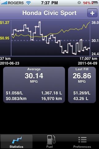

I own a 2010 Honda Civic, Manual transmission. I've been tracking the fuel efficiency with an app on my phone since i bought the car.
In the beginning, the fuel efficiency was great (better than my previous Civic that i leased). It averaged at 35MPG (6.8L/100km).
Shortly before the winter, it started turning consistently worse. In a matter of a month, it reached average of 26MPG (8.8L/100km).
I did my maintenance every time the light came up, even did it at the dealer. I even tried those fuel injector cleaners when i first noticed the issue. Then i changed the petrol station that i filled up at. No help. I then decided it was the cold winter and winter gas that was to blame.
But now, the weather is warm, and the "winter gas" stickers are gone from petrol stations, but it didn't improve...
What could be the issue? Unfortunately i know nothing about tuning up the car. So i guess my real question is: if i take it to my dealer and explain the problem, could they fix it? Or will they charge me tons of money to perform an "inspection" that will say "sorry, we don't see anything wrong"?

Winter gas is more volatile than summer gas. Also, your car idles higher when you start it in the colder months. On top of that, you're running more accessories such as lights, heater, defroster. All these things start to reduce your gas mileage in the winter. Read up on winter gas to get all the facts on it. Once they switch back over to summer gas, you'll notice it go back up. Nothing is wrong with your car. And yes I'm aware that you said they switched back, but they probably just put that sign up now that the weather is getting warmer and actually haven't done the full switchover yet.

Has your driving style changed? Places that you drive to? etc. 26mpg is pretty average if your doing mostly city driving. I mean, it's a bit low, but not something is wrong low.

Thanks guys, just what i needed to hear. I will wait a bit more till the normal gas comes and will see if that improves.
To answer previous question: no, my driving didn't change, same route to work, about 50% on highway, 50% city (percentage is in distance)
