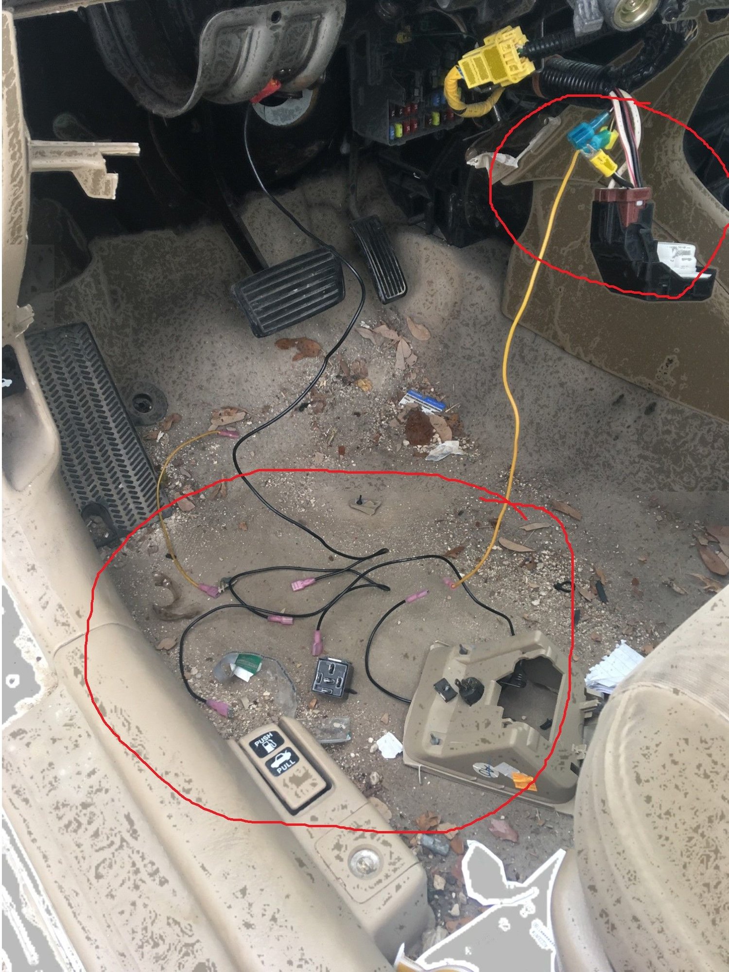

So someone thought it would be fun to unplug my ignition wiring and I don't know how it goes back any ideas?
I have a 5 prong amp with about 7 wires unplugged. Also I have a picture I can send by email of how it looks. Any help would be great.

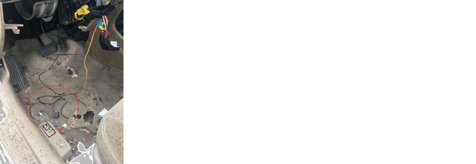

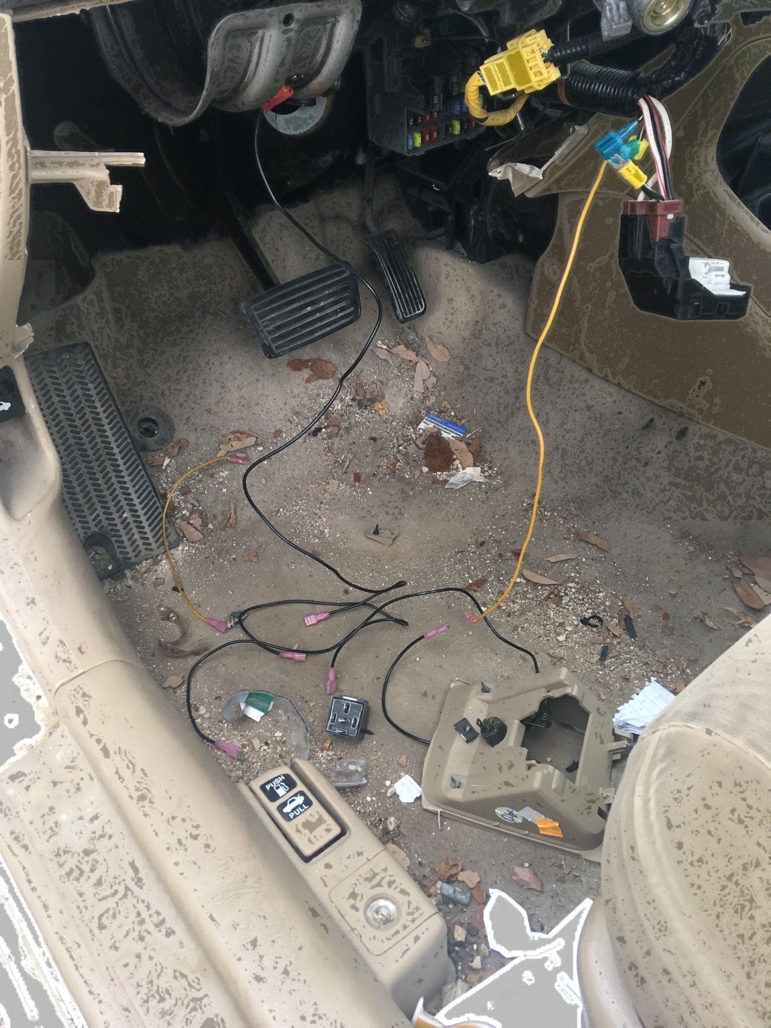

Hope these pictures will help figure it out

um. Holy crap.
That's some aftermarket finagling. I have no idea why there's a random relay laying around. Are there any aftermarket modules or anything? otherwise, logic tells me that all you need to connect are these 2 wires, simply based on location and wire colors.
Edit: Then again, the wire with the yellow t-tap and blue spade connector are the same color, as well. Closer to same AWG, too. I rescind the advice from the picture. I'm going with the black/white wire with the yellow t-tapped wire coming off it and the wire with the bottom arrow in my picture.
Old 12-29-2017
Join Date: Dec 2011
Location: Midwest. Aiming about mid-chest
Posts: 32,019
Received 250 Likes on 182 Posts
Rep Power: 493
Re: Wiring help 2005 Honda Civic DX
Match up the wire colors exactly, black/white to black/white.....black/yellow to black/yellow, etc.....
you'll have to get creative and splice them back together so it makes a damn reliable connection that can handle a lot of amperage.....and sufficiently insulated so it doesn't cause a short or start a fire.

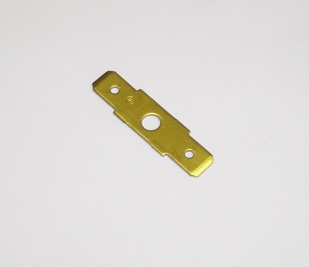

Assuming the terminals needing connected are all female: You might be able to find some 'male to male, quarter inch spade terminals' similar to one of these:
The relay was intended to be a starter kill or ignition kill, either way it was intended to disable the car.....it could have been part of an anti theft or car alarm, or maybe a buy-here-pay-here revenue assurance device (payment prompter).
